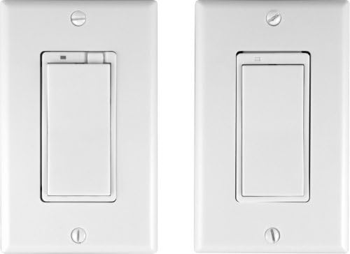

You need to get a 3 way switch/dimmer kit.

You need to replace both unless you plan on leaving the secondary leg on all the time. The z-wave three way can be used at either end and the states will get properly updated in the ST app. If you leave a standard switch in the mix, then when that switch is off it kills the power to your z-wave switch.
You have to replace both but be aware you will need a neutral at each end. It isn’t just a straight replacement. It has been a while since I swapped mine out but I believe you can use one of the extra travelers as a neutral if needed.
