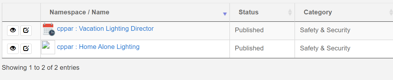

Hi I have copied and pasted the code and published two smartapps. These smartapps are now on my android phone but the lights do not turn on.
I am now trying to delete the apps from the IDE but there is no option to delete.
Any ideas on how to delete/remove these apps as I would like to start again.
cheers
Click in left edit icon.
Then options delete appears
