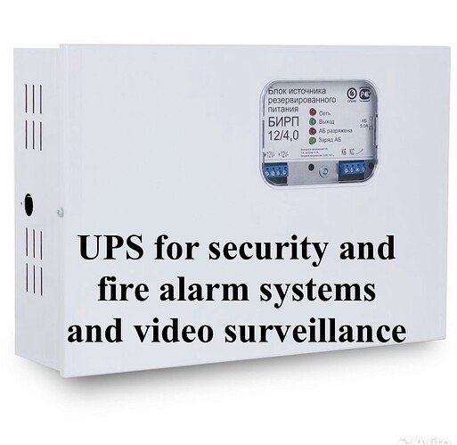

Computer UPS is not a good fit. It is designed for a high-power consumer. The No-load current will “eat up” more than the router itself and the ST hub.
I use an industrial UPS for security and fire alarm systems and video surveillance. Everything “industrial” is not beautiful, and does not have intelligence.
But it is not expensive, and it is easily modified (improved/upgrade).
I used a 24 volt UPS and added two DC-DC converters for 5 and 12 volts.
5 volts on the ST hub and 12 volts on the router.

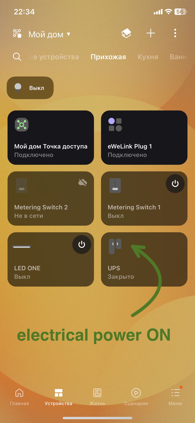

We will connect the door opening sensor to the relay.
The sensor will send a command to the ST hub.
The ST hub will inform you that there is no power supply in the network, everything is powered by an emergency power supply system.
