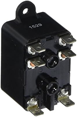

How about any ST compatable Stat, 24vac power supply and 24vac relay to handle the current of the heat. Like this handles 12amps at 125vac

@celblazer That is exactly what i originally wanted to do, but after reading stuff online i scared myself. How would the aforementioned be connected together ? Going to try and figure out a diagram for the connections on my own in the meantime :smiley:
