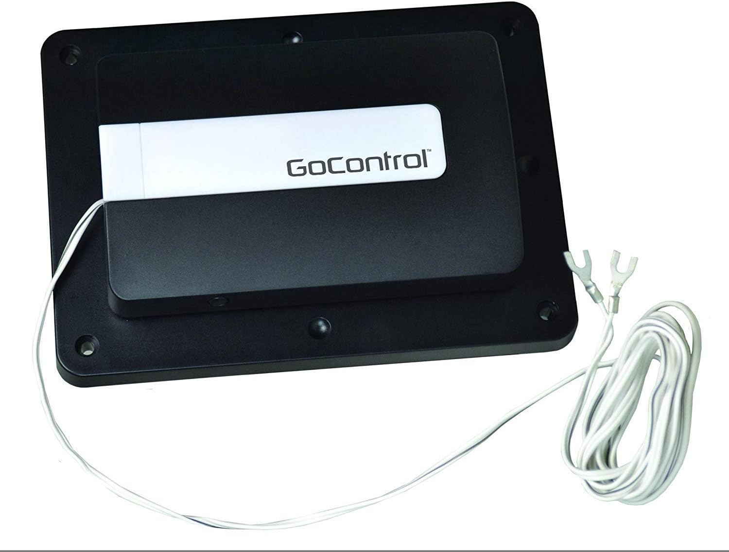

Actually mine is Linear/GoControl branded GD00Z-4
Wapirz-1, they are rebranded go control, https://www.gocontrol.com/detail.php?productId=15
I can send you one if you want.
I’ll follow up via PM.
In case this is of any help, there were two separate versions of the Gocontrol GD00Z4. The original was Z wave classic, the second one was zwave plus. The firmware was different, everything else was the same.
