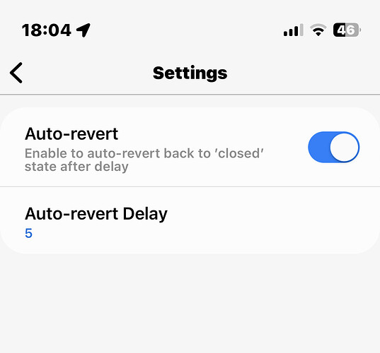

Each trigger has an auto revert that you can set it’s time in settings
Is that setting in the contact tiles that are created or in the parent? As it says “closed” I assume that it is in the contact tile not the parent device. I didn’t see anything like that in the parent settings, keep in mind I don’t want the separate tiles as I’m trying to reduce my device count.
I had just deleted the device and driver hence the questions otherwise I would have checked myself.
Those settings are in each trigger/tile, so maybe that’s not what you’re looking for.

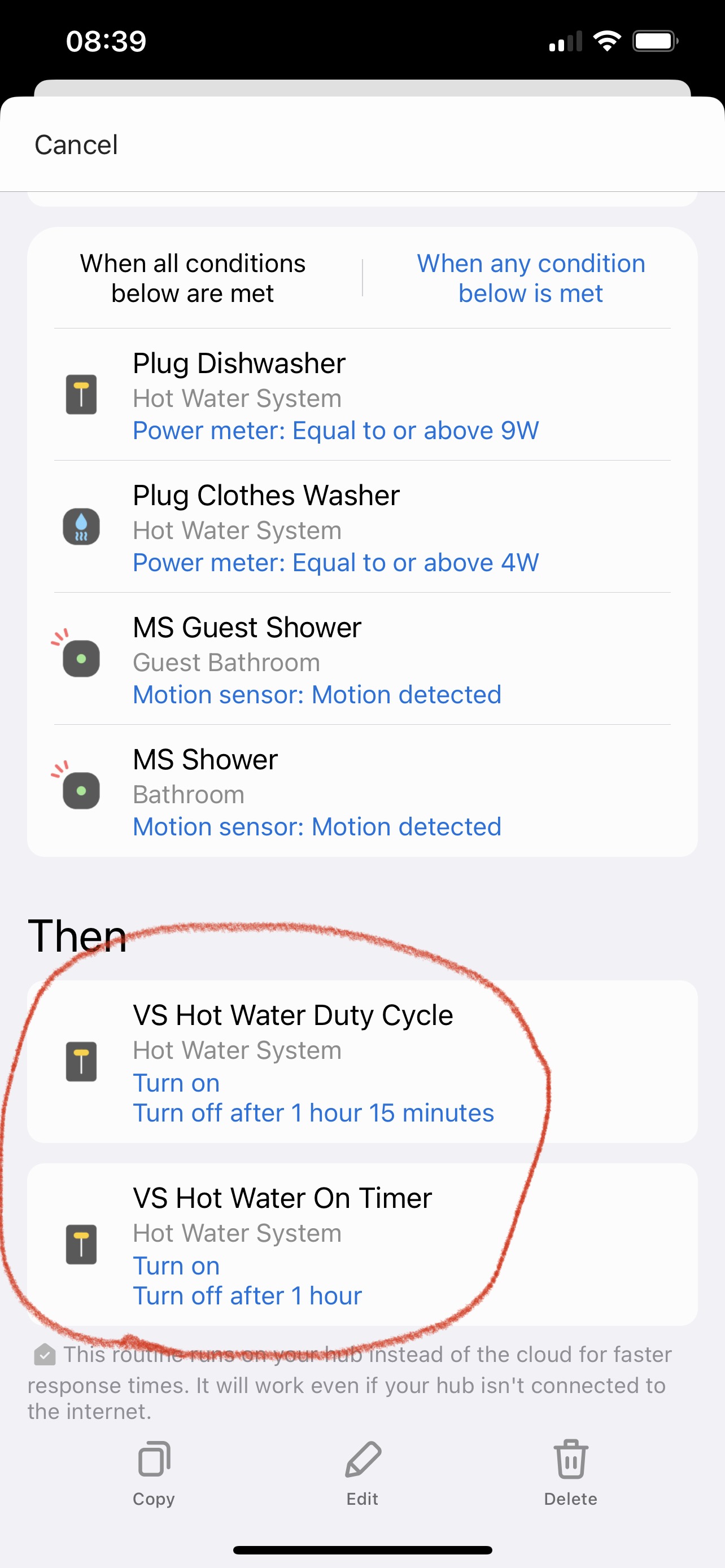

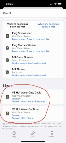

You need to write 2 routines for each virtual sensor. One to turn it on and a second to turn it off. The following is an example.

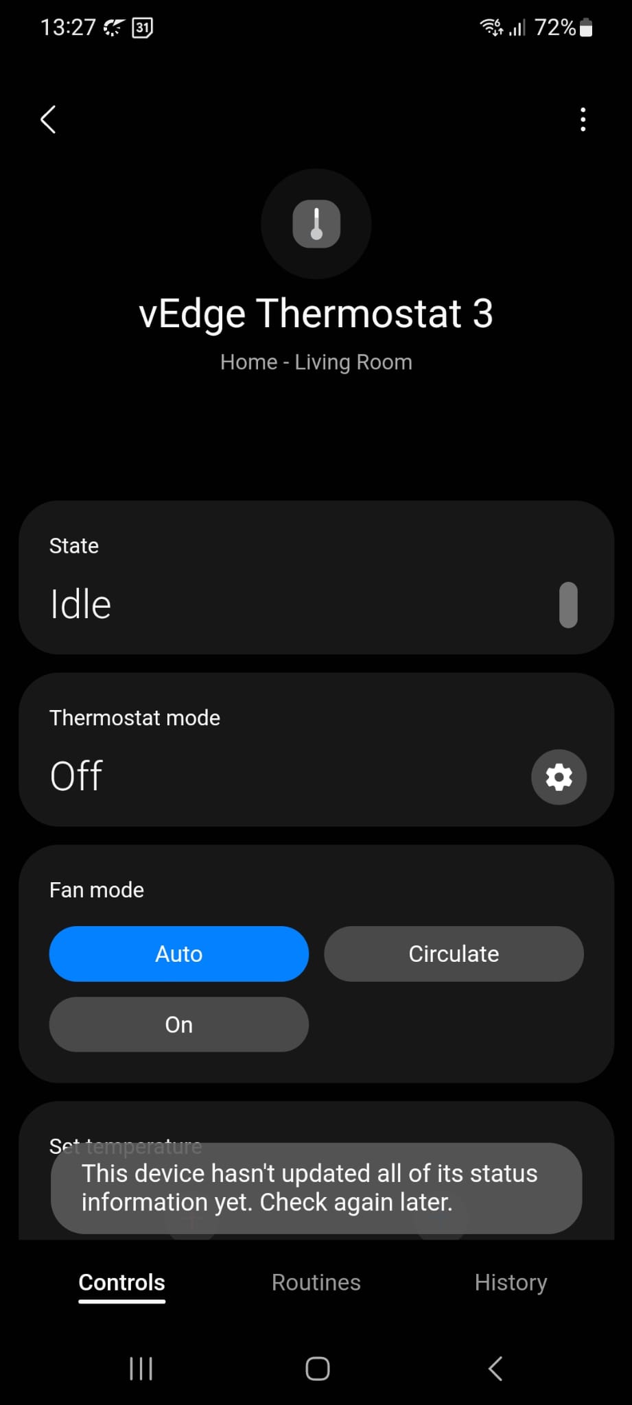

I’m trying to use virtual thermostat but I keep getting the message: “The device hasn’t updated all of its status information yet. Check again later.”
And I’m unable to set/adjust the temperature.
Can you help please?
Yes you are right - I am seeing this as well. I will work on a fix and get back to you shortly.
I’ve just pushed out a driver update to fix this issue. Please monitor your driver version to confirm you get the update (could take up to several hours): 2023-08-01T15:09:45.521809442
