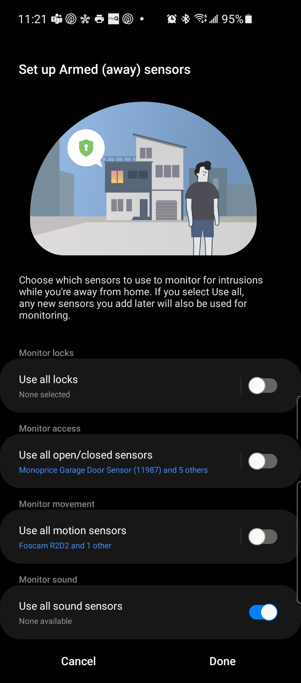

I’ve installed and created some sensors etc - can I use these sensors in STHM? I just get no sensors connected when I click on it and I can’t find a way to get it to find the ones I’ve made.
Was hoping someone more familiar with STHM might have answered your question. I don’t really use it, so am not sure. I thought I’ve seen posts by folks saying they have used them with STHM but maybe that was through automation routines.
I see what you mean about the vEdge motion or smoke devices not being listed to select from within the STHM setup screens. Maybe Edge devices aren’t supported yet?
But how did you get those devices added to STHM? Are they showing up in the list of devices to pick from in the STHM setup screens? They don’t on my iOS app.
I am using an Android phone and they show up in the list of devices you can use in STHM. I just added 1 of your virtual motion detectors to STHM without any problems.
I was just corresponding with some one on IOS that could not connect the motion from a Ring Camera to STHM. I can do it with no problem on Android.
So maybe it is an IOS problem.
I was just checking mine again and I DO get vEdge motion sensors listed in the Security device setup list, but I don’t get a vEdge smoke detector listed in the Smoke device setup list. I actually have no ‘real’ Smoke detectors, so the screen is blank and only lets me turn on or off the switch for ‘Use all smoke detectors’.

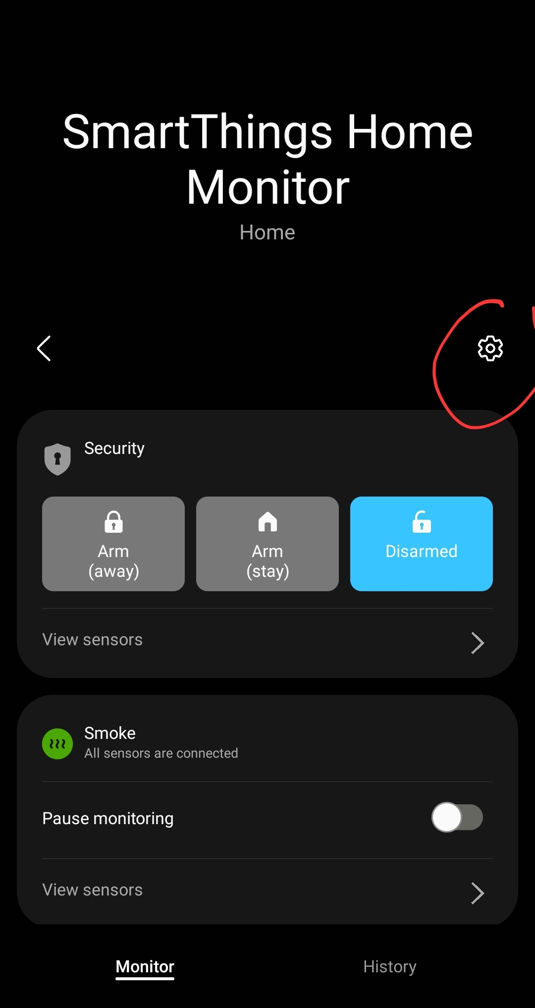

Mine was on iOS, but it was a bigger problem with SmartThings not recognising any sensors, real or virtual. I stumbled across a community post that suggested deleting STHM and reinstalling it, and it all works perfectly. Thanks though.
This is weird, I created a LAN device that uses the smokeDetector capability and it appears in the STHM. The option of “Use all Smoke Detectors” must be inactive to see the other page. Is there where your device doesn’t appear?
Well interestingly… my virtual smoke detector now shows when I select the STHM View sensors for Smoke. It could be the app update I got today… or this: Before I checked STHM, I went to my virtual smoke detector and ‘exercised’ it, meaning I flipped a switch which triggered the state to smoke detected and back off again. Maybe Smartthings didn’t consider it fully initialized before that?? (It had not ever been triggered before that)
That said however, if I actually go into Set up Smartthings Home Monitor, select Smoke, then Set up smoke detectors, there are no smoke detectors listed. If I toggle off that switch for “Use all smoke detectors” I still get nothing shown. You mention it has to be inactive “to see the other page”, but on my app, there is no other page.
The procedure is the same, but when I flip that switch off (‘Use all smoke detectors’) the app does not go to another screen; it just stays on that one.
