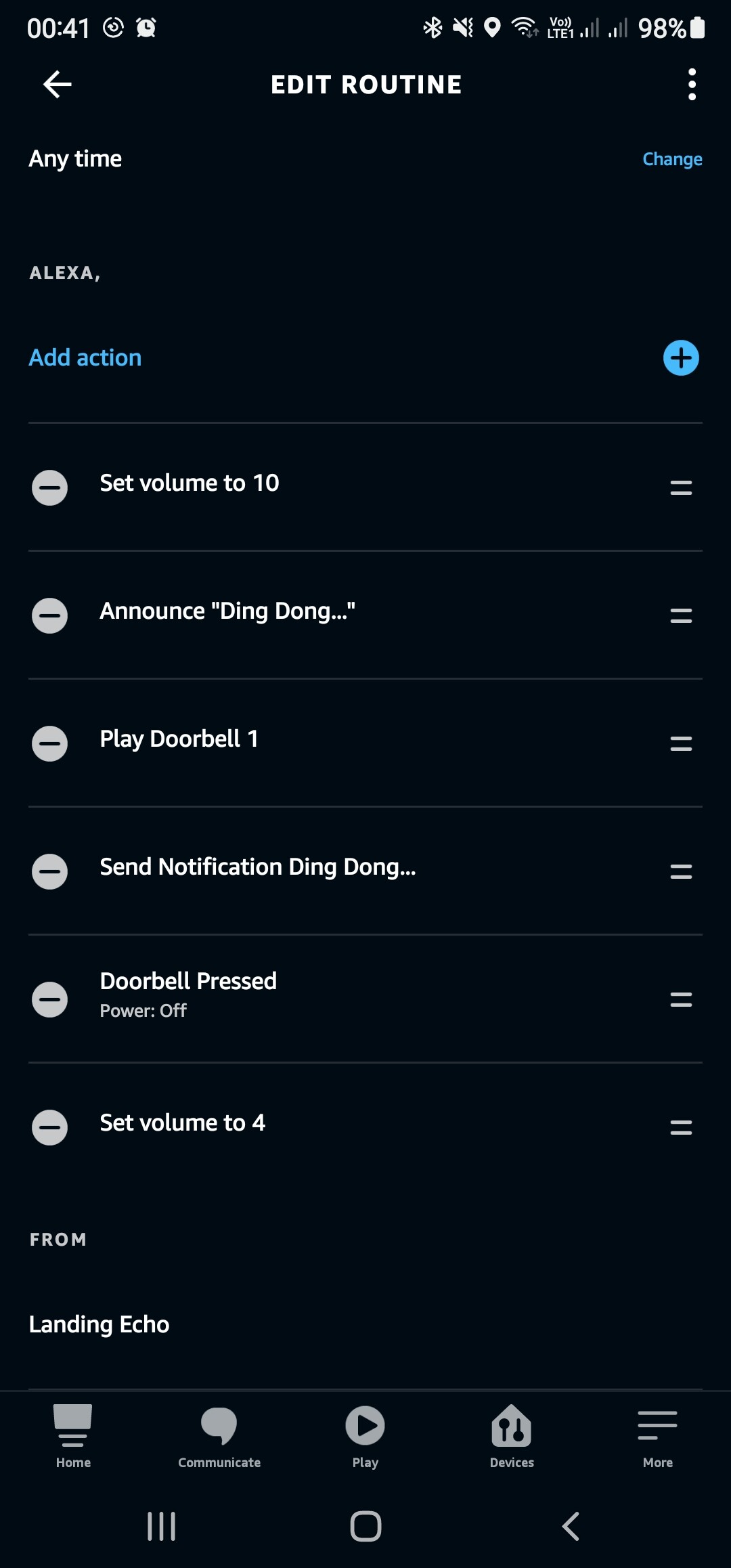

Well that is a bugger,
Currently I am using Routines that makes Doorbell Sound on one device. But announces “Ding Dong” so the announcement comes from all the echos, just not the Sound.
Screen shot attached of current Routine.
I suppose I could duplicate the same Routine for each of my 11 echos :rofl:
Damn Amazon… Corporate Greed!
