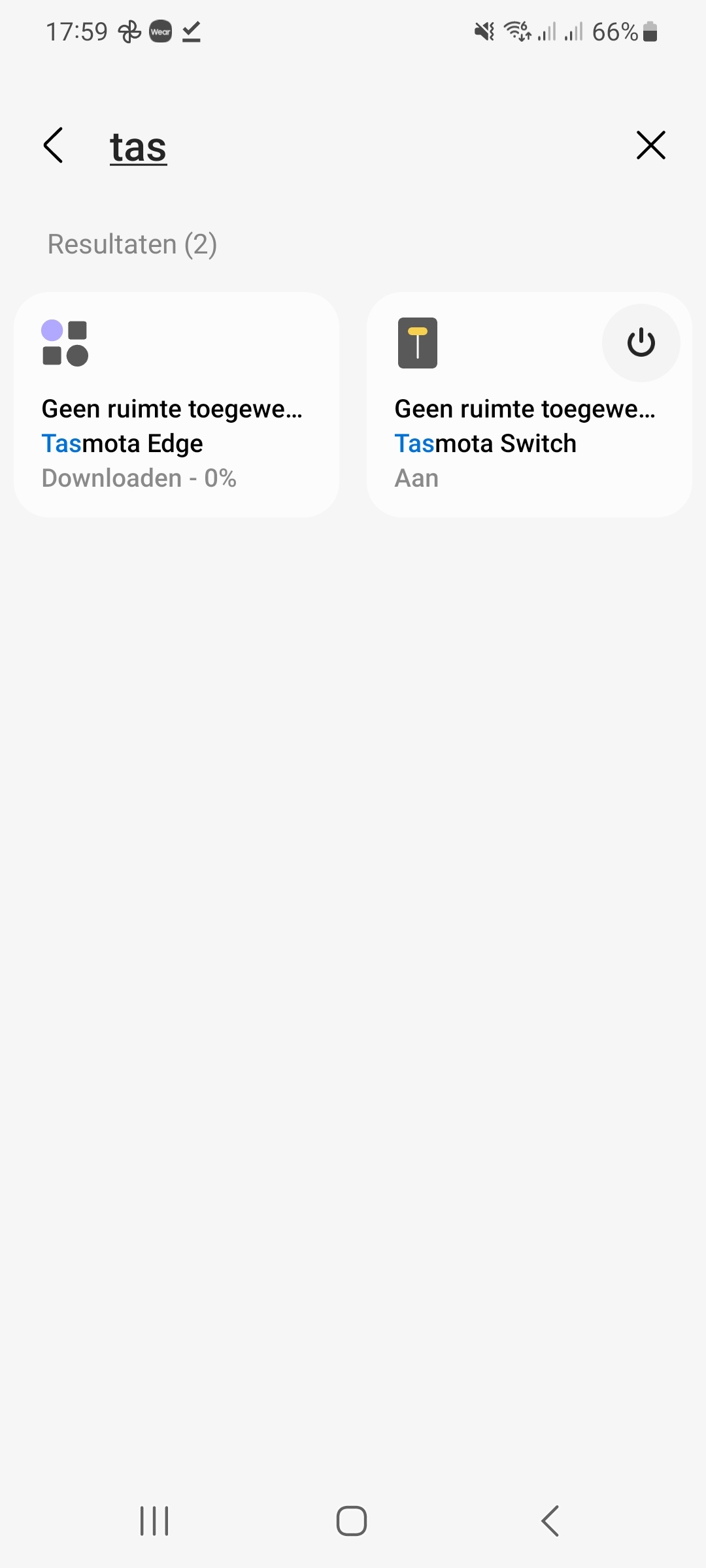

Hallo, can’t find an answer: on one hub I have Tasmota Edge installed and working.
In another hub with another Samsung account, I installed Tasmota Edge, but it remains invisible.
Any hints to get it working?
Can I have the link to the thermostat / template?
Have you installed? Is that a ST hub v2/v3 or aeotec? It seems to be a hub issue.

Hi hongtat, it’s a V2. I installed it, now I have the option Uninstall.
Tried a second install by uninstalling and reinstall. Rebooted the hub, tried on different Android devices… No result.

I saw an “Tasmota Edge downloading” when I wanted to view settings. Any changes?
