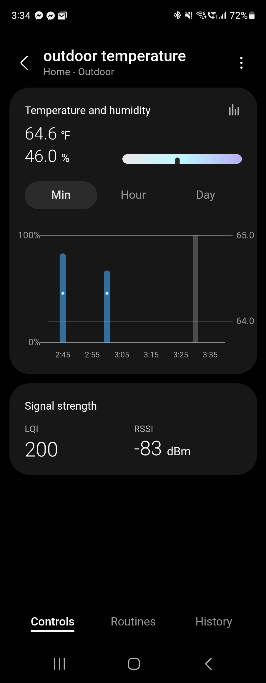

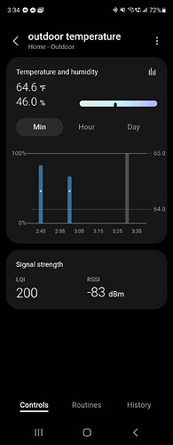

Not sure if this helps. Its a temp sensor, humidity, with time and date from aliexpress. Its showing only in Fahrenheit with no way to switch to Celsius, and cant do anything with time and date. Any help would be amazing. Thanks for even looking.
Are you sure?
Dp 1 = temperature (21.7C)
Dp 2 = humidity (78%)
Dp 4 = battery percent (53%)
I am not really sure what Dp 14 and 15 are.
This is what i see.
This is the sensor
https://a.aliexpress.com/_mPUBI7o
https://graph.api.smartthings.com/location/list
or
Please, check the temperature scale from your location.
That worked for the farenheit to celsius. Thanks, i never knew about that portal.
Just still dont have the ability to fix date or time.
What you mean fix date time ?
Top left is time and then date, but no idea how to adjust it.
oh, I see your point. I will try to fix it this weekend. I think I already know where is the problem.
Awesome! Cant wait to see it. I appreciate all your effort!

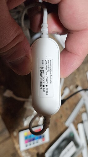

Also, just curious if this zigbee rgb controller can also get looked at. It comes up under generic switch. Switching profile doesnt help either. It only offers on and off with no color change, no random switching or fade options.
Thanks again. Sorry, i just got into smartthings and are finding out some of my older devices dont work with edge. Thanks in advance.
