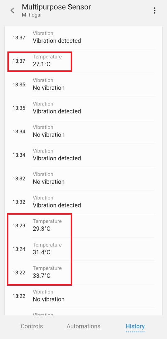

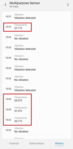

Ok, I think I figured it out.
I updated the previous Gist so you can take a reference:
The change is similar, but:
  • It is done in a subdriver.
  • I added the device:configure() instruction which configures the other capabilities with the defaults (thank you for that)
  • I removed the temperatureMeasurement from the supported capabilities list as this is sent to register the defaults.
  • I added a handler for the temperatureMeasurement cluster (measuredValue attribute) and call the parsing method in the defaults
These are my results:
  • The updates are sent when there’s a change in the temperature of 200 or above
    • This can happen at any interval of time
    • The values are shown correctly in the device history (in the corresponding timestamp)
    • This is a comparison table of the values:
Timestamp Reported Value Parsed Value
13:10 3238 32.38 > 32.4
13:12 3498 34.98 > 35
13:16 3711 37.11 > 37.1
13:22 3365 33.65 > 33.7
13:24 3143 31.43 > 31.4
13:29 2927 29.27 > 29.3
13:37 27.13 27.13 > 27.1
There will be differences between DTH and Driver behavior. What must not change is the configuration set up for the device. If you want less often reports, change the 200 for a greater value or the minimum interval allowed for reports.
