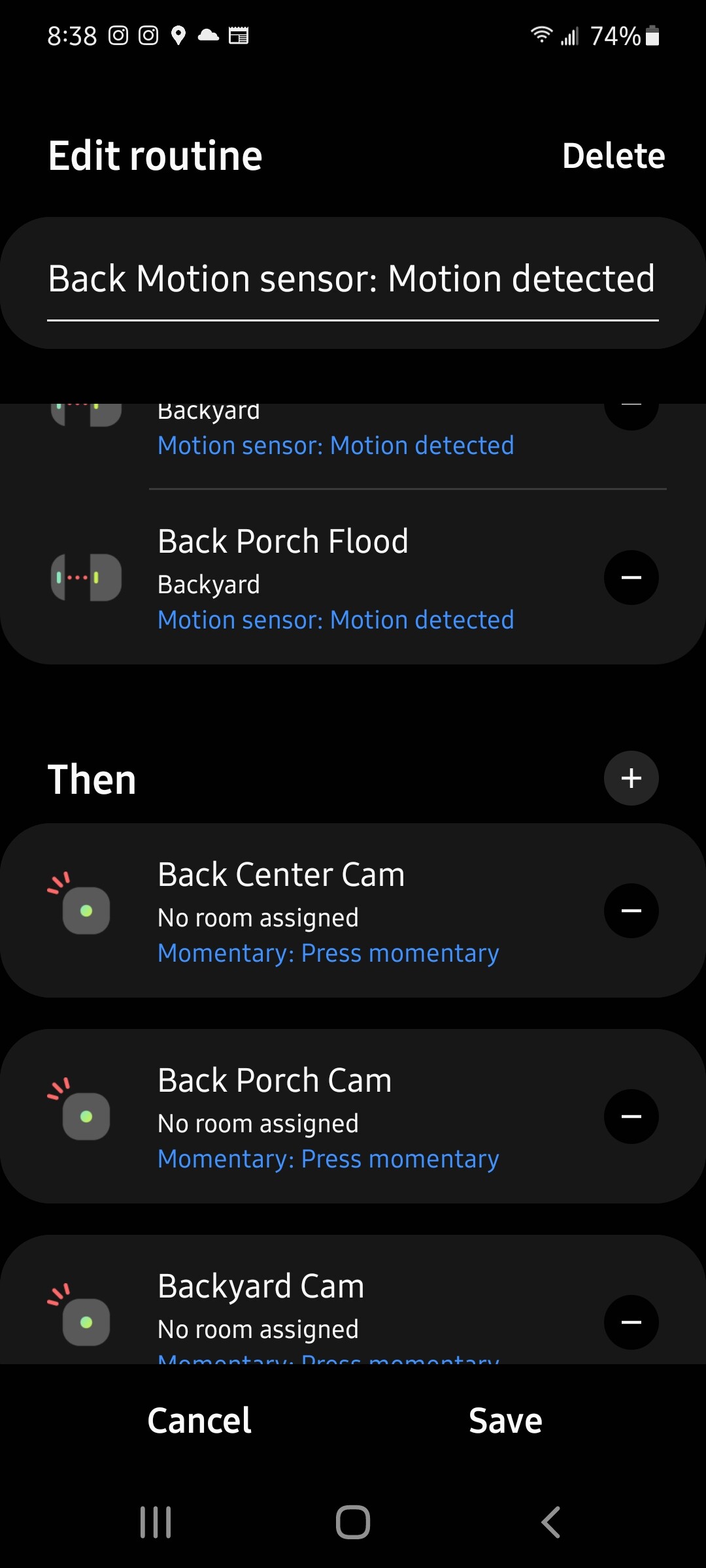

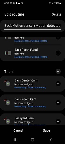

Everything looks great. I figured out the missing piece (I struggle with business requirements at work too) to what I’m looking to do. @netcsk stated it well. I need the momentary to allow triggering of the device but I also need a field to store post data and send a web request when the momentary is triggered. Then I can use a routine like the one below (without having to add the the 3 separate web request actions).
As a very early preview, I plan to have my various motion detectors trigger an autocast of my cameras (various views) to all of my Nest Hubs and select Chromecasts.
Thanks again (to you too, @netcsk ) for your working adding local integration of Blue Iris with SmartThings!
