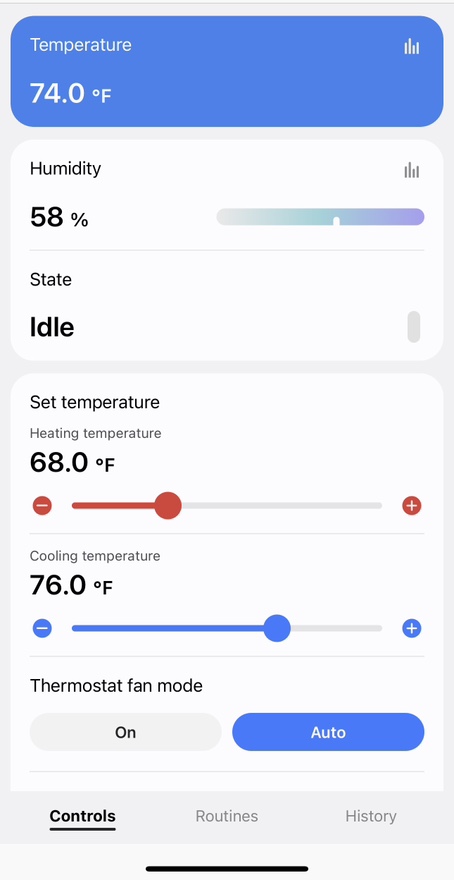

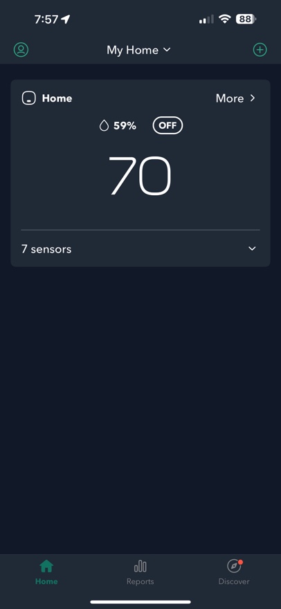

I recently noticed that ST is showing a different temp reading than what my Ecobee 4 thermostat has. At times is just 1 or 2 degrees but like today it was 5 degrees difference. This doesn’t seem to be a delay in reporting to ST as I have watched for quite some time and refreshed the screen with no change in the ST reported temp. I am not having any other cloud to cloud interface issues with other devices in ST and I am able to control the thermostat in ST. So not sure if it’s on the Ecobee of ST side. Wondering if any others are having a similar experience?

@Andreas_Roedl Confirming it’s not the set point.
This was from earlier today. Note the variance was only 1 degree.

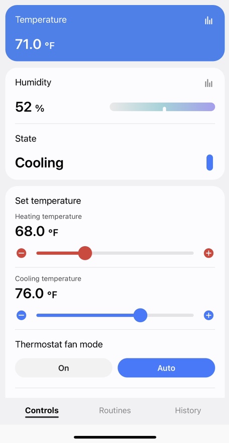

But later in the day it went up to 3 degrees.

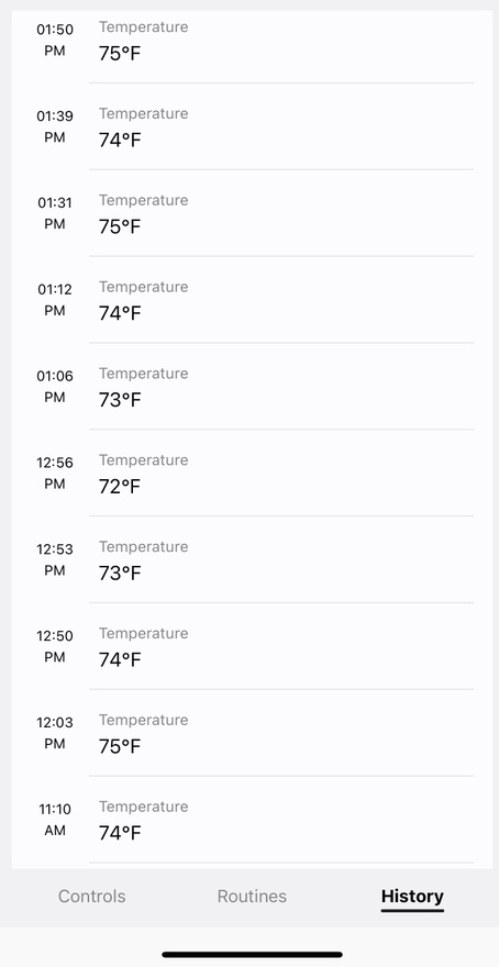

@HalD You might be on to something. Looking at just the temp reporting history it seems to only report when the temp changes. This is also the same for humidity.
But it doesn’t explain why there is a variance throughout the day and why that variances changes.
