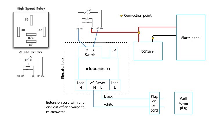

this should do it - the micro controller should pair up as a switch - at that point the relay will act as if a user is turning the switch on and off using the siren.
if you do this get a relay with a harness on it so you can use wire nuts - I usually solder and heat shrink everything,you really don’t need to do that.

@pascal, when I get home today I’ll post a picture of the siren box and then I’m mostly likely going to implement your approach of using the siren to trip the relay that activates the switch that alerts SmartThings. It’s seems like the easiest way to go for right now to achieve the basic goal of letting SmartThings know when the ADT alarm goes off.

I purchased the Aeotech Microswitch G2 (model DSC26103-ZWUS), and wanted to utilize it to detect the opening/closing of a simple single-pole switch, and alert me to that opening/closing via Smartthings (via a text and push message). The end objective is to connect a relay in place of that switch, and have the relay activated by the 24 volt siren output of my alarm system (so as to alert me when the siren engages). The circuit I am trying to replicate is shown on the Smartthings forum, on the March 2016 date (you will see a schematic shown there kindly posted by pascal).
However, for the purposes of this support, please assume I have a simple single-pole switch connected to the ‘switch’ contacts of the Microswitch. 110 volt power is applied to the AC power connections, and nothing is connected to the ‘load’ terminals of the Microswitch. I simply want the Smartthings hub to detect the opening/closure of the switch and notify me, and I am having difficulty doing this.
