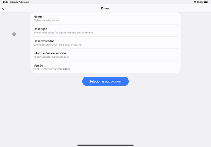

Looking at the driver you have installed it’s for a humidity device. The sensor we are referring to is the SNZB-02LD which has an attached probe and is temperature only. Are you sure you don’t have the SNZB-02D which is a dual temperature and humidity sensor?
It also looks like the driver developer is not “SmartThings” so it’s not the stock driver. The driver date is November 2024, so whatever driver it is it’s not updated either.

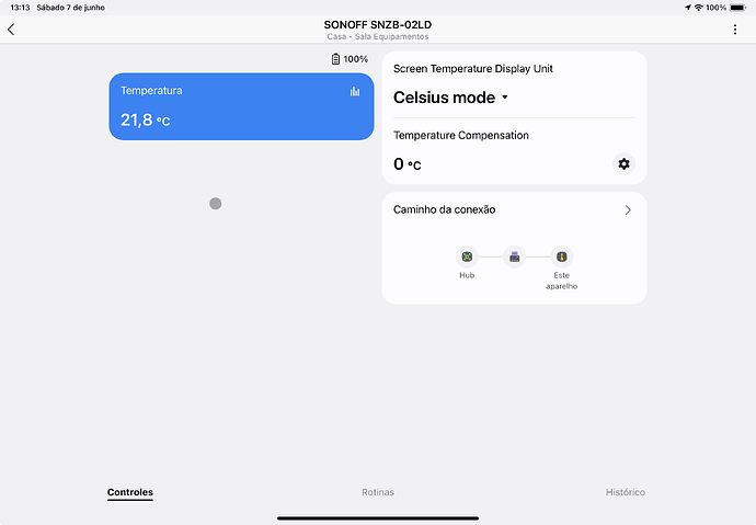

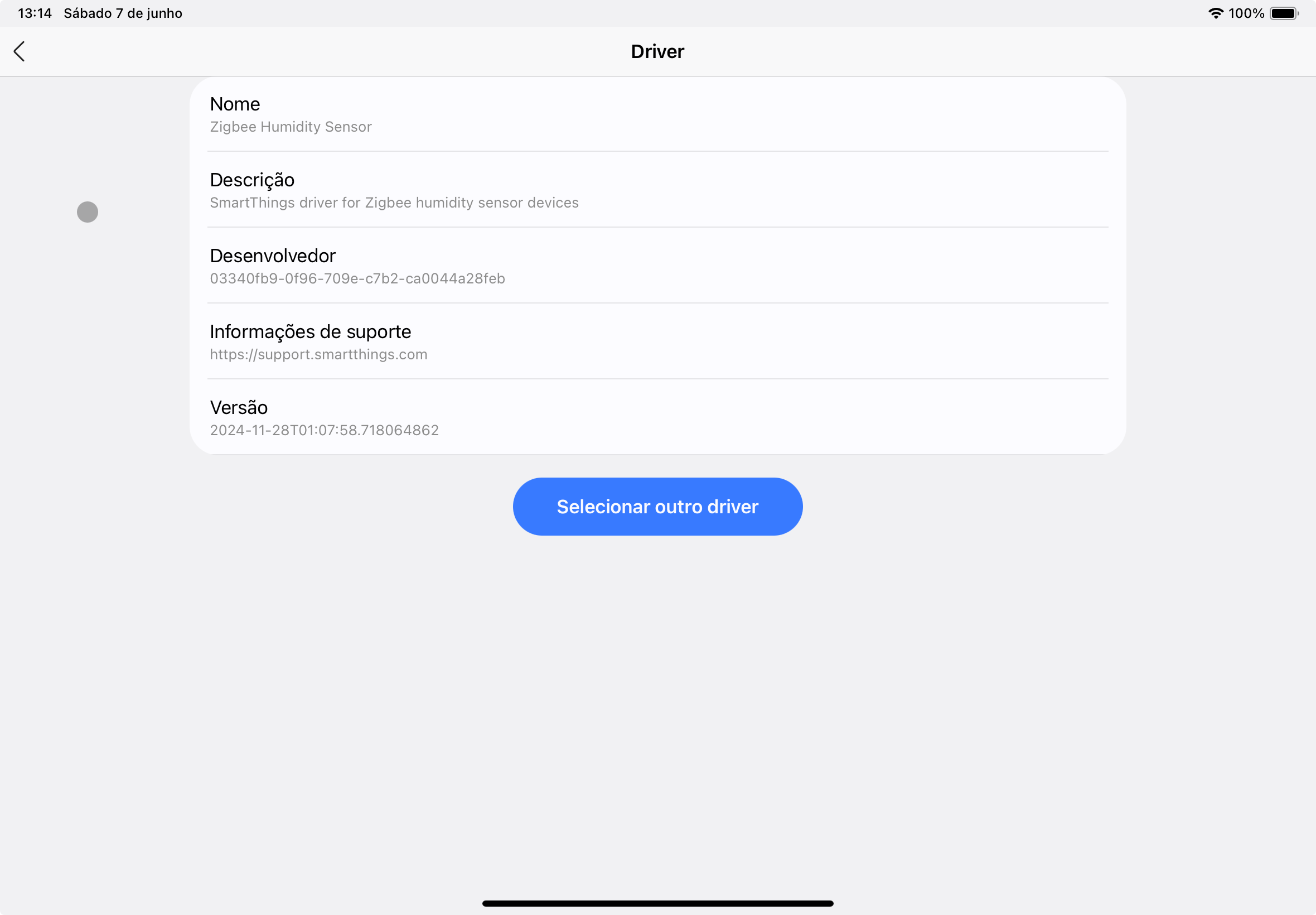

Yes, my sensor is exactly that one, I received it from Sonoff at launch
But your driver doesn’t look like the stock one (doesn’t say “SmartThings” as developer and is quite outdated), which one is it? Maybe there is indeed a custom driver from Sonoff that you have installed from other devices without knowing.

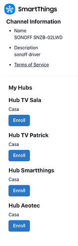

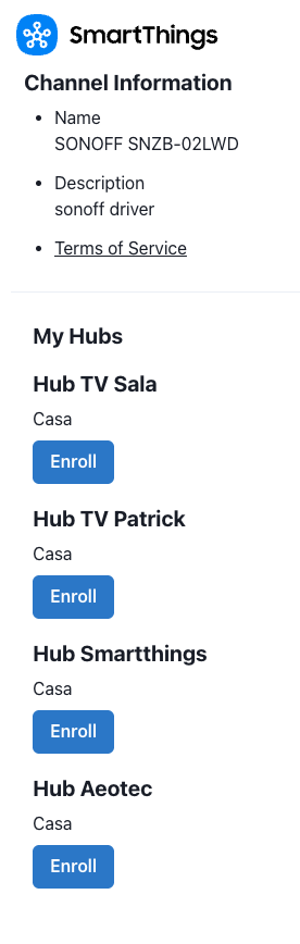

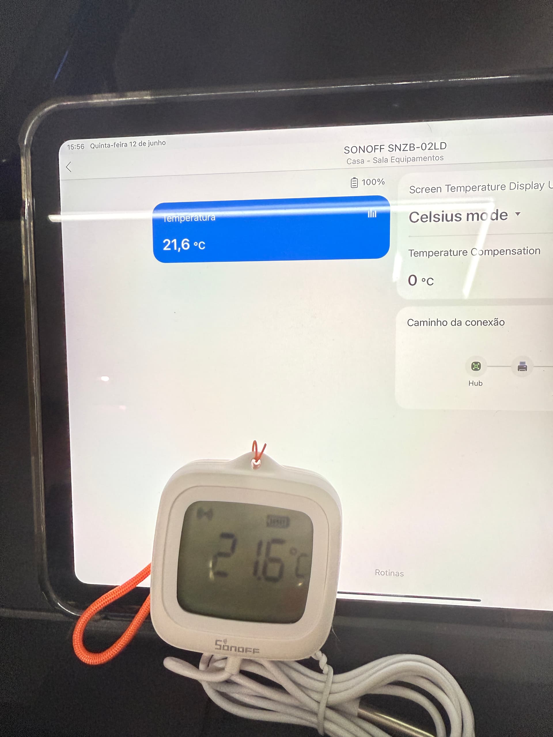

Try this one, Sonoff sent me at the release, but I’m no longer using it as I can see on my channel print.
And this is for the other sensor released together, but it can work for this one.
Actually you are! I found it strange that “SmartThings” was not the developer, turns out Sonoff created the custom driver without modifying the text of the stock driver, so it reads:
  • Zigbee Humidity Sensor
  • SmartThings driver for Zigbee humidity sensor devices
But it’s not the stock driver, it’s the one made by Sonoff that can be installed from your link.
