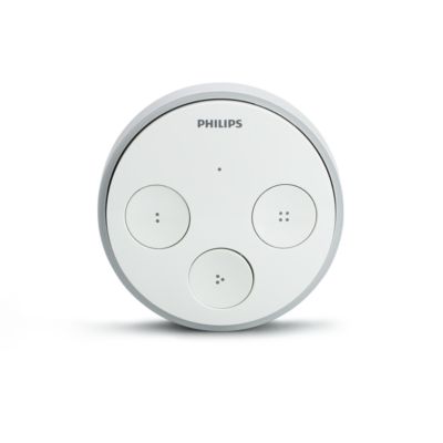

The Phillips hue tap switch is using zigbee green power, which is why it doesn’t require battery. It works just fine to send a single scene code to the bridge.
But the Phillips dimmer switch is a ZLL device. It does require a battery. And that’s because it is capable of doing more than the tap switch does.
Both types of devices have a place in home automation. Choice is good. :sunglasses:
