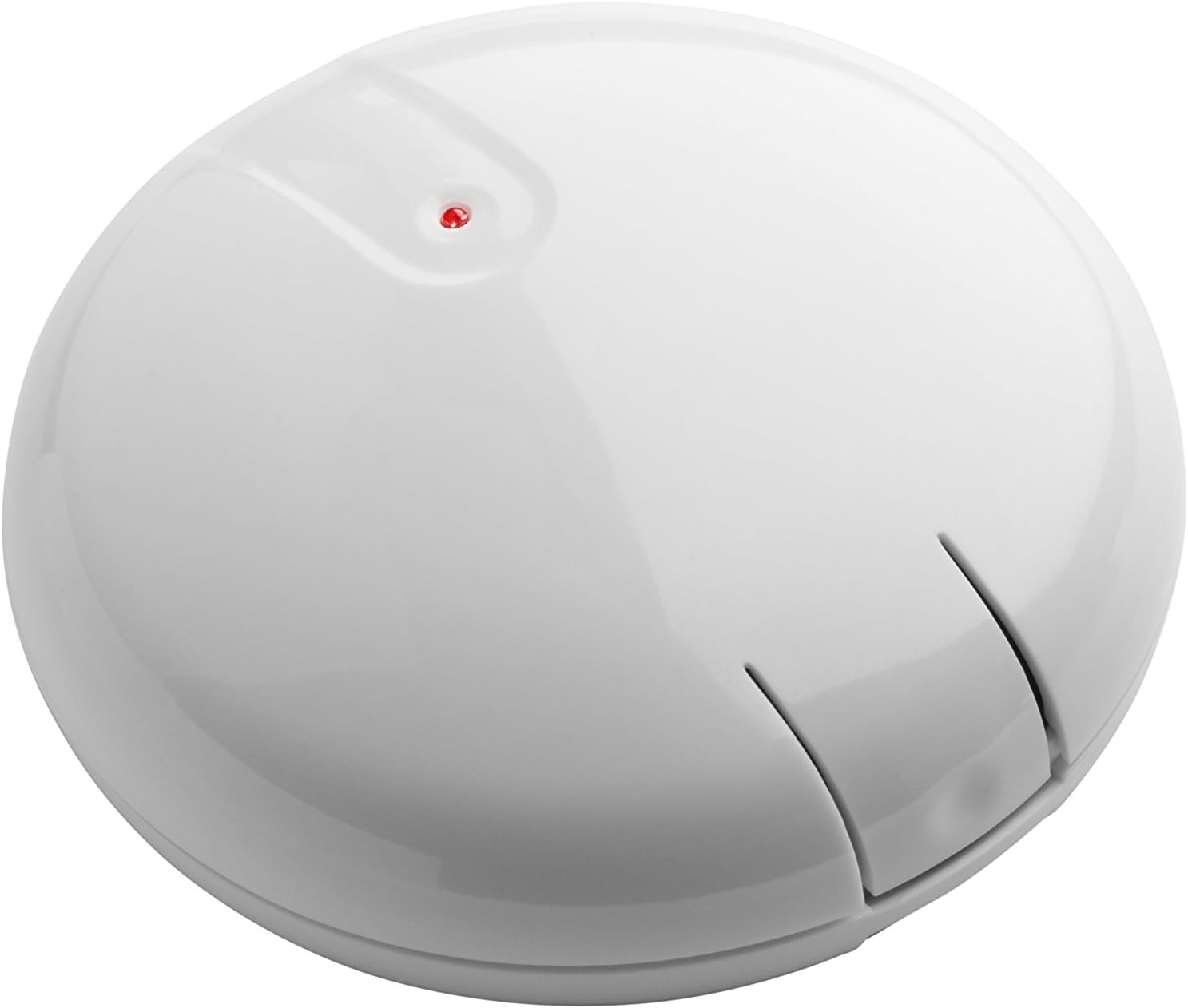

I have Frient smoke detectors. Not much to say about them…
Going to replace them with
… as soon as they are available. For no other reason than Matter over Thread.

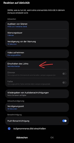

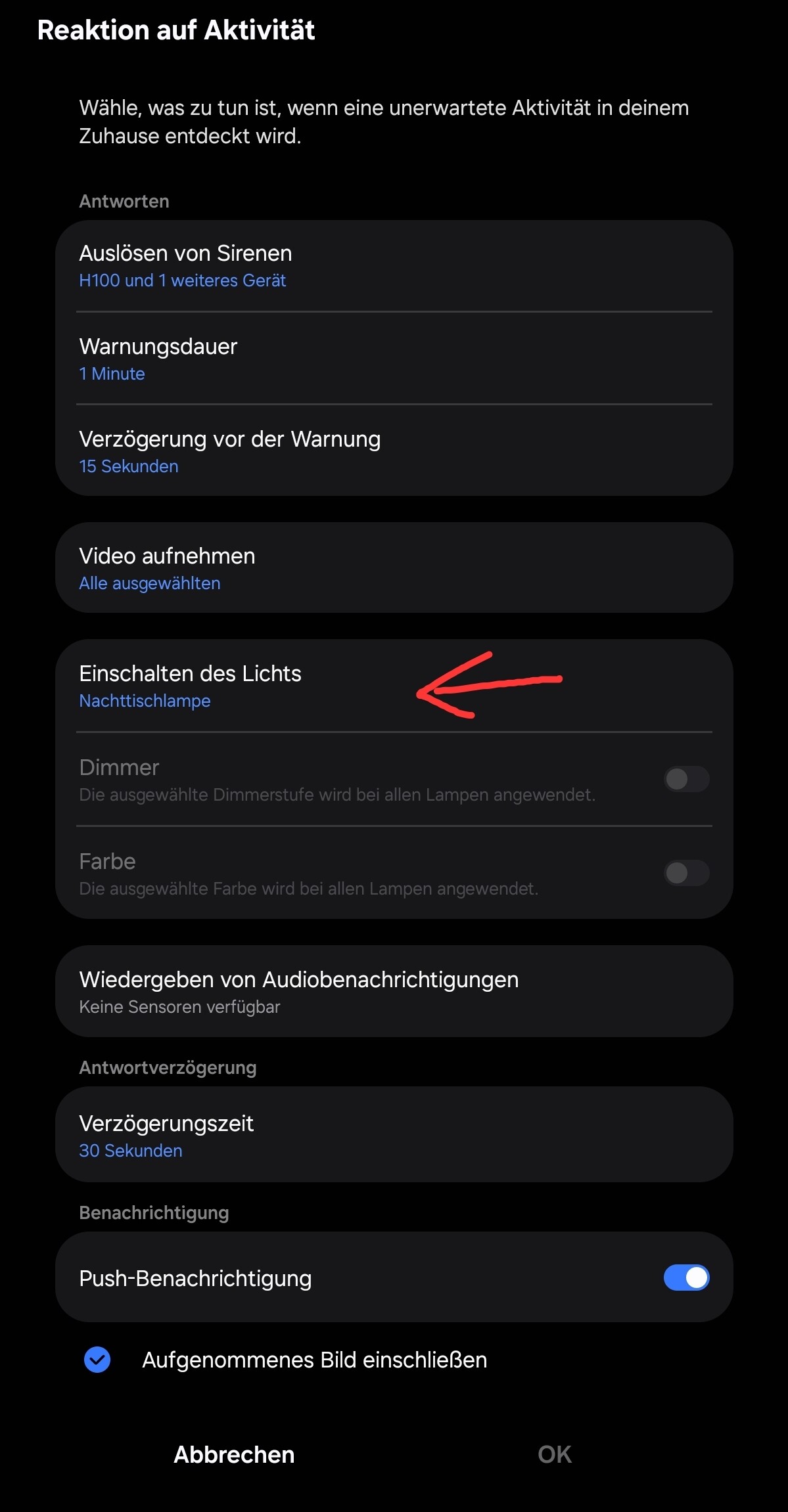

Home Monitor takes care of that.
