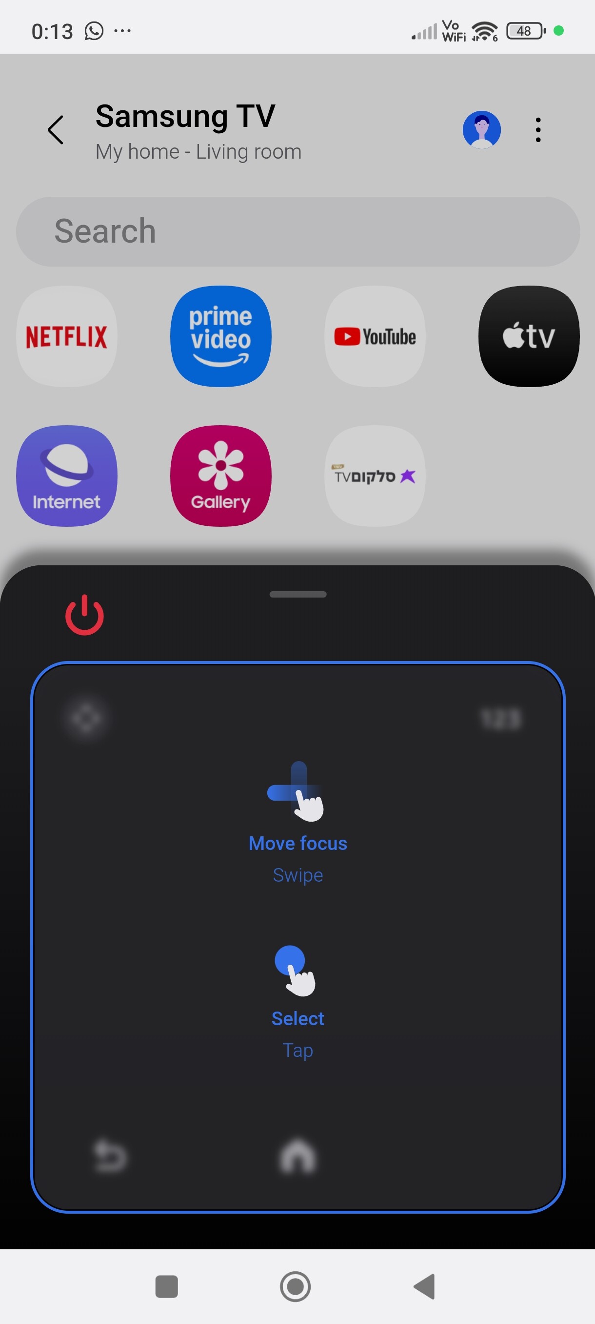

Having the same issue here.
Strangely, I do manage to turn on/off the tv, and press the home button. But all the rest is completely unresponsive. This is how it looks.
If anyone find any kind of solution, I’ll be glad to hear about it…
