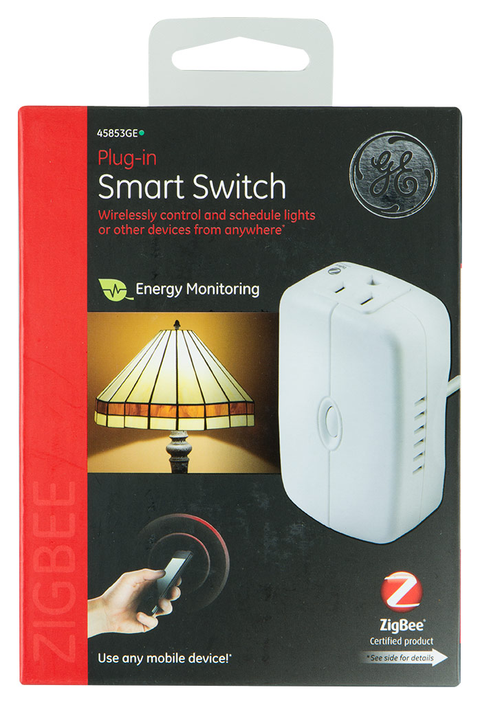

Probably, depending on exact placement. A Zigbee pocket socket is also a repeater. I like to use those to test placement because they’re easy to move around. Then when you find a good place you know where to put a switch.

And Iris has a really interesting one that is a Zigbee pocket socket that also includes a Zwave radio and so can repeat for both protocols–and is actually one of the least expensive options.
I think what JD means is anything that uses zigbee and plugs into an outlet. However I don’t see the purpose in doing this, it seems like a waste since I don’t have a use for it when I’m done finding a good location.
For me I have 10 3-way switches and 3 4-way switches throughout the house that I plan on connecting with ST so that’s 29 possible places to put the zigbee smart switch. I’ll just start in the middle between the hub and the farthest zigbee sensor and work from there.
“Pocket socket” is a UK term for a device that plugs into a wall outlet and has a place to plug in a regular corded device like a table lamp or small appliance. I like the term because it makes a clear distinction between a wired inwall outlet and a removable plug-in.
I think people most commonly use them for corded lights, including LED strips. Other than that, it just depends on what you have that you want to be able to automate for on/off.
