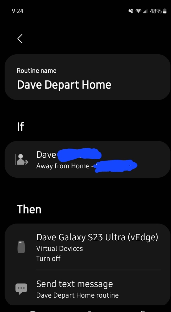

So I have virtual presence sensors defined, and their value set by the ST phone:
So the virtual presence sensors will change to whatever the ST phone presence sensors are.

I made 2 vEdge presence virtual switches for each phone:
  • Dave’s (Alexa) Presence vEdge
  • Dave’s (ST) Presence vEdge
Alexa ROUTINES:
Dave Depart Home
  • IF Dave (Away from Home) THEN Dave’s (Alexa) Presence vEdge = OFF
Dave Arrive Home
  • IF Dave (At Home) THEN Dave’s (Alexa) Presence vEdge = ON
SharpTools RULES:
  • If Any “Dave’s (Alexa) Presence vEdge”, 'Dave’s s23 (phone)" CHANGES to ‘Present’ THEN “Dave’s (ST) Presence vEdge” = ON
  • If Any “Dave’s (Alexa) Presence vEdge”, 'Dave’s s23 (phone)" CHANGES to ‘Not Present’ THEN “Dave’s (ST) Presence vEdge” = OFF
I then use the “Dave’s (ST) Presence vEdge” virtual switch to determine if I’m actually home. Appears to be working.
Is this similar to what you all are doing?
