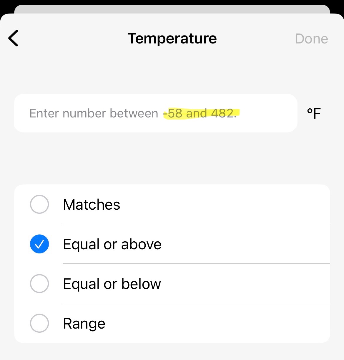

In the last 30d, we’ve had lots of temperature problems. A few weeks back all our sensors (switchbot - internet linked) moved to return temps over 300F. Fans turned on alerts kept firing. It was all of them. I blamed the connection with that brand, so bought replacement zigbee sensors with edge support for all of them.
I’m trying to now recreate complex routines for all the rooms and the iOS app is limiting temp based routine entries to 70.4 and 71.1.
This range is…. Unusable.

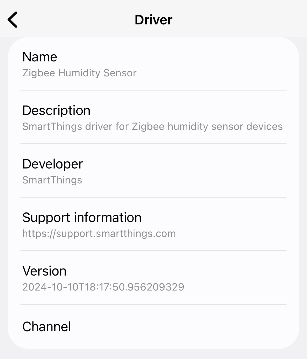

This is a smartthings natively authored edge driver. Version 2024-10-10T18:17:50.956209329

In this example above specifically, I’m creating a refrigerator temperature alert. But the issue is showing for any temperature driven condition I’m trying to create right now.
Here’s a different device on a different edge driver showing some other specific temp driven examples I created months ago, but is what I’m having to recreate in different rooms after replacing switchbot. I’m now not sure if they’re working and don’t want to touch their definitions.

I don’t think it’s an OS issue, but certainly could be driver related. That screenshot is for a routine using a gen 2 Iris open/close sensor and ST’s standard Edge driver. As y’all can see the range selection is very wide.

That’s what the device is reporting, according to this:
These are Maxcio Tuya-based sensors… which I had checked in advance can use one of the community tuya edge drivers.
But, the Samsung Native Edge driver worked straight away, so I hadn’t tried that yet. It’s on my list, but was surprised by this very narrow limitation.
