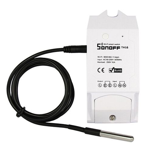

Do you know sensors with external probe? Like this one?

SmartThings has always supported some devices that use a probe sensor like the DS18B20 sensors that @S.F.B mentioned, including some Aeotec and qubino zwave models, as well as the popular Sonoff mains powered range. The probe itself can handle a wider range of temperatures and is wired to the radio/battery piece which is kept in a more temperate zone.
People in this community have been using this kind of device for many years for both saunas and freezers.
So the operating range of a typical all in one battery powered sensor should not be a UI design limitation for all sensor reporting. A typical probe sensor will have an operating range from -55°C to +125°C.
