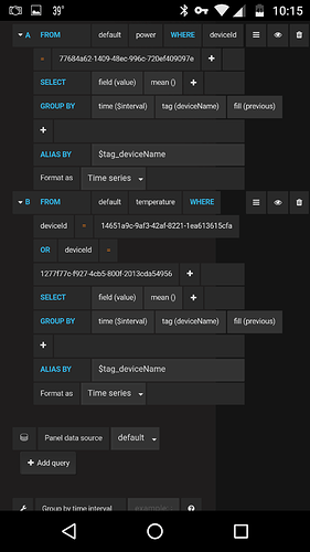

Would anyone mind sharing their dashboard JSON code? Really don’t want to creat one from scratch.
Each use case is very different so that may not be effective. It’s really easy once you follow the basic tutorial in that post. The hardest part is documenting which device ID goes to which device, I keep a spreadsheet with that relevant info. Here’s the config for an “all” graph for one variable.
And a combo with x and y overlaid.
