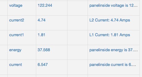

Go into the SmartThings IDE, go to My Devices, then click on the appropriate device. All the attribute names and corresponding values will be listed in the section called Current States.
Attribute names are probably case-sensitive. Looks like you have current, current1, current2 at least…
Hmm … my device’s current states only show power (W) and energy (kWh).
are the attributes as noted in the “Events - List Events” section?
Please post a link to the DTH you’re using…

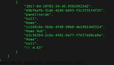

looks like the names are from the events list as current1 and current2 now show up in influx, but the unit type “A” is not being assigned (is “null” in screencap), and there are two "\ " and a space in front of the value. power1 & power2 show up with the unit type also as “null” but have a numeric value instead of the string "\ " looking type.
DTH is actually this one, modified for the reporting values i want to see:
(my edits, numbers from the Aeon HEM Gen5 spreadsheet). haven’t figured out how to report kvar & kvarh, voltage1, voltage2, yet though they are included in the parameter value.

Ok, there are a number of issues with the DTH which are causing your problems:
  • The custom attributes (i.e. current1,current2, power1, power2) are not defined in the metadata section. These should be added.
  • When events are created they have a zero-length string for the unit. This is where they need to be defined, e.g.
          sendEvent(name: "power2", value: dispValue as String, unit: "", descriptionText: "L2 Power: ${formattedValue} Watts")
          // Should include the unit like this:
          sendEvent(name: "power2", value: dispValue as String, unit: "W", descriptionText: "L2 Power: ${formattedValue} Watts")
Note also, the DTH does not raise events for voltage1 or voltage2, which is not surprising, as voltage meters like this tend to only report one figure anyway (all of the clamp channels are assumed to be the same voltage).
