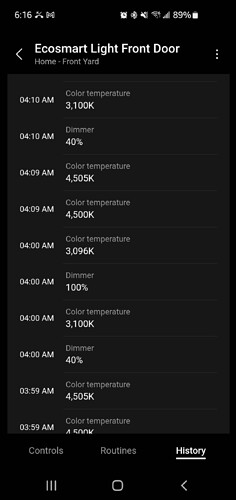

I have noticed this too couple nights ago, but didn’t report as there were a lot of ongoing bigger issues on platform. But this is correct, if you have level and white temperature change, in reality only temperature changes, level stays the same.
Bigger issue that history is showing changes of both level and temperature, however not the temperature set in automation.
It should be 4500K@100% or 3100K@40%

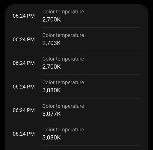

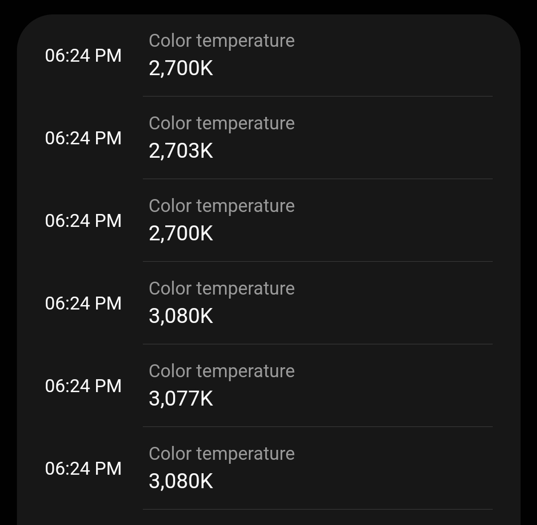

Every time temperature readjust to different value, and if I remember correctly we used to have Temperature rounding calculation issue couple months ago.
If I move slider, for temperature to minimum level 2700K, it readjust to 2703K, then if I slide it again to 2700K it stays there. Same with preset points, if I select first preset 3080K, it readjust to 3077K, and by selecting same preset agen, it stays on 3080K
