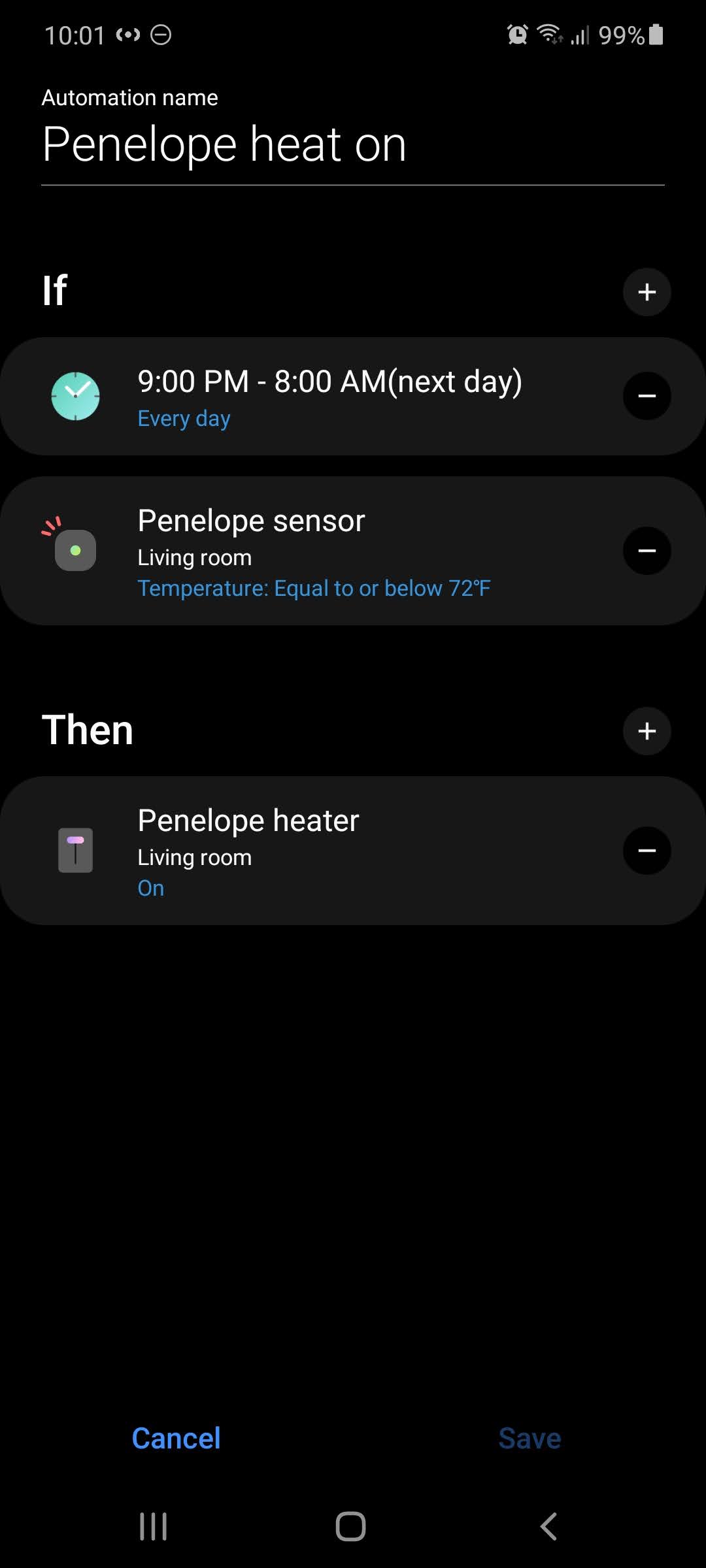

The screen shot shows that even though the temperature is below 72F for over an hour past 9:00PM, the heater never turns on. I just tried toggling (disabling and enabling) the automation and it turned on at 10:04PM.
The Automations would be so much better if we actually knew what logic they were trying to implement and exactly when they evaluated it.
It might be that condition is only true when it first detects the temperature is <= 72F and if that event happened before 9PM the automation doesn’t activate.

FWIW, I have found a solution that works for me within ST. The issue with the trigger for time range and specific temperature was that if during the time range the temp had already fallen outside the trigger threshold, then the automation would not run. So for example, “b/t 9pm and 7am, if temp falls below 70F”. This automation would only work if b/t 9pm and 7am, the temp was already above 70F and falls below the threshold of “below 70F”. If the temp at 8:59PM was 65F, then the automation will not turn on. B/c for the rest of the night, the temp would never go above 70F naturally.
So what I did was add additional automation triggers that at a specific time, if below a certain temp, then turn on the plug. So like at 10PM if below 69F then turn on plug. Then another similar one but at 11PM.
This approach has been stable enough for my needs.
