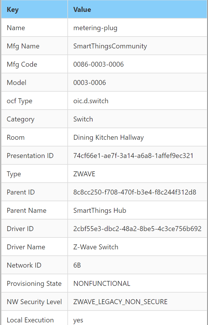

been there done that,I have used the stock drivers, Mariano’s driver and philh30. makes no difference. it seems like devices that i paired and then changed the drivers.
I was able to change a few of my Ge switches from the stock Zwave switch edge driver to the philh30 driver and they changed from NONFUNCTIONAL to PROVISONED. So Im guessing it has something to do with the driver. I have several Aeotec Multisensor 6 devices that I paired with the driver created by Aeotec and they show NONFUNCTIONAL?
@TAustin Do you know what the difference is between NONFUNCTIONAL and PROVISONED is in the API?
I certainly don’t, but the other two possibilities for the provisioning state for ‘widget devices’ (whatever that means) are TYPED and DRIVER_SWITCH if that helps anyone join the dots.
I checked all of these sensors now and 2 of them show PROVISIONED and 2 show NONFUNCTIONAL thier all using the same driver? I wouldn’t really care but i’m trying to figure out why some of my routines no longer work now that thier local and they worked fine in the cloud. I’m thinking it is one of the devices with a bad driver. NONFUNCTIONAL dosen’t sound good to me and I have searched the forum for it but didnt see anything pointing to what this means.
