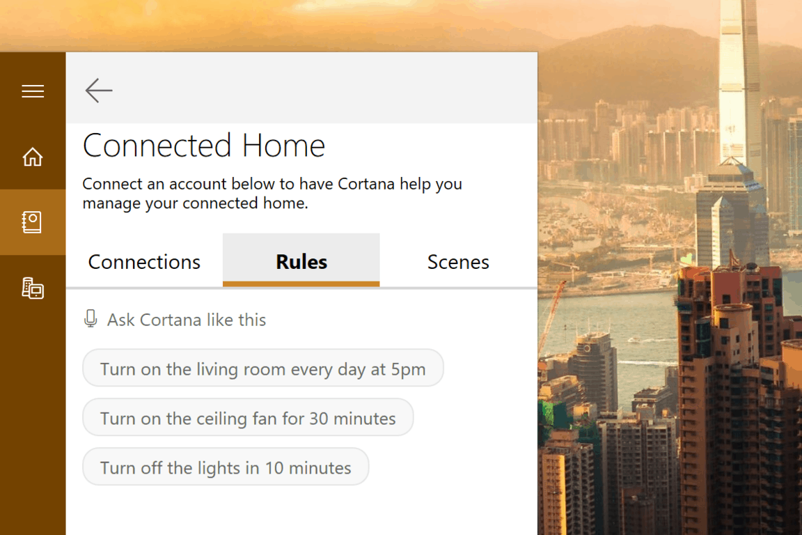

Hello,
I have been using Windows 10 - Cortana with my only SmartThings location / Hub v2 for several months.
Recently, Cortana started saying there are no devices that it can control. If you go to settings, I see all is connected, but no devices are appearing.
Tried to disconnect ST from Cortana, and in ST app remove Microsoft, and reconnect again. All connected again, no error. But still Cortana does not see any my ST devices.
I have several ST bulbs which I used to control with Cortana/voice, but now I can’t anymore.
P.S. It looks like some update with “scenes” from Cortana side that I did not notice before.
Anyhow, Cortana with SmartThings does not detect any ST devices now for several days.
Any idea?
I been testing it and have found it only controls my TP Link, Hue, Alexa, but nothing at all from smartthings…
I have an issue where I can get Cortana to Connect to Samsung Smarthings, but as soon as I give Cortana a command, it asks me to authenticate yet again. I authenticate again it displays code at this point, which appears to be a success.
On the Samsung apps, it shows Cortana successfully connected, but the integration is still broke. Any ideas?
In a nutshell, it looks like I am caught in an authentication loop where it never caches the credentials necessary to make this work solely with voice integration.
Microsoft did terminate Cortana for lot of countries, and lot of integration, for me, Cortana is dead for SmartThings, I have moved to Alexa.
I am more interested in hearing back from people who do have it working. I appreciate the recommendations, but I am looking for a solution to solve my particular issue.
Has anyone run into the issue I am describing, and if yes, what if anything did you do to resolve it? Thanks in advance.
I got this working after realizing you don’t need to say “Samsung” in the commands. If you do say Samsung it brings up a command to connect and leaves you stuck in an unnecessary loop. Guess, I will be getting some more mileage out of Cortana after all.
