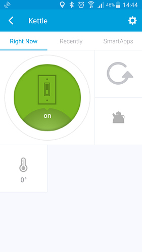

I’m afraid it’s still not working for me;
2017-02-24 14:43:10,740 - INFO - 200 SUBSCRIBE /api/192.168.1.154/smartthings (192.168.1.179) 1210.72ms
2017-02-24 14:43:10,840 - INFO - 200 GET /api/192.168.1.154/status (192.168.1.179) 22.81ms
2017-02-24 14:43:10,944 - DEBUG - SmartThings Handler
2017-02-24 14:43:10,954 - DEBUG - SmartThings Handler
2017-02-24 14:43:12,959 - DEBUG - SmartThings Handler
2017-02-24 14:43:16,999 - DEBUG - SmartThings Handler
2017-02-24 14:43:17,016 - DEBUG - SmartThings Handler
2017-02-24 14:43:19,018 - DEBUG - SmartThings Handler
2017-02-24 14:43:19,028 - DEBUG - SmartThings Handler
2017-02-24 14:43:21,039 - DEBUG - SmartThings Handler
2017-02-24 14:43:23,058 - DEBUG - SmartThings Handler
2017-02-24 14:43:25,079 - DEBUG - SmartThings Handler
2017-02-24 14:43:25,090 - DEBUG - SmartThings Handler
2017-02-24 14:43:27,098 - DEBUG - SmartThings Handler
2017-02-24 14:43:27,108 - DEBUG - SmartThings Handler
2017-02-24 14:43:29,119 - DEBUG - SmartThings Handler
2017-02-24 14:43:31,220 - DEBUG - SmartThings Handler
2017-02-24 14:43:35,179 - DEBUG - SmartThings Handler
2017-02-24 14:43:35,189 - DEBUG - SmartThings Handler
2017-02-24 14:43:37,198 - DEBUG - SmartThings Handler
App does not appear to get any status updates back?
Edited to say that 192.168.1.179 is the ip of a powerline network extender! what is that ip in brackets in the log file?

Kettle and Coffee control works - the only problem is that no status updates get back to smartthings.

What events are you looking for in particular? If you need real events it can be done but it’s harder. But if you just want the on/off status to be updating in fairly reasonable time, you can just implement the Polling / Refresh capabilities in the device handler.
** Just in case it might help somebody **
My problem is fixed. Needed to change the format of the MAC address in the device handler to exclude the ':" and to capitalise - so ‘B827XX30BE3’ in my case
