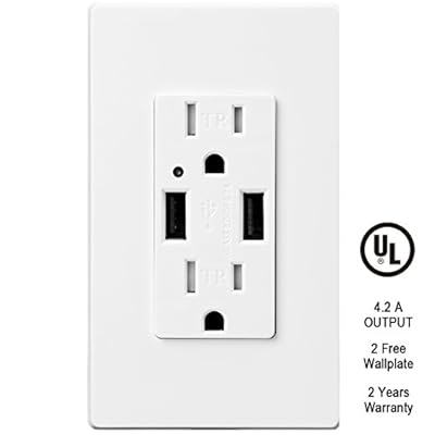

Does anyone know of any smart switches that have 5V 2A switched USB outputs? Bonus points if they do not have 120V output at all (making them smaller).
I have seen some that have 120V switched outputs, and 5V USB but the USB power is always on on those devices that I have looked at (I think).
You can have this USB/120v outlet and have an on/off relay module behind it. I would go with the Aeon because of the bonus power consumption option. Just be sure to have enough room with your gangbox and it’s not meant for your microwave or high power devices.
