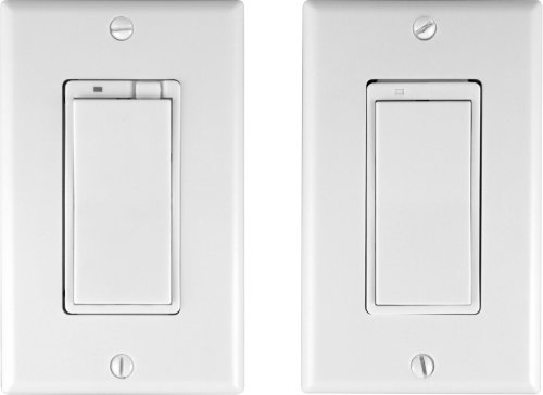

The traveler is not used on the Linear, that is what is great about them. You may need to use it to get power to the switch itself, though. The “three way” switch just won’t control the load directly like a traditional setup. Basically, you need to determine which line is coming from the breaker panel, put the load switch there, and then put the three way switches in the other boxes.
From what you say, it sounds like I would have 3 switches to install? A load and then the 3-ways? Forgive me if I am misunderstanding this, but I want to make sure I fully understand it all.

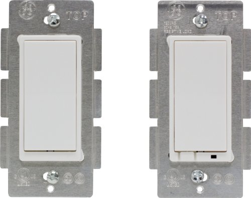

No, you would just replace those two switches. If the traveler wire is there and you only have two switches to replace, there are kits (like the GE) that use the traveler wire and may be easier to install if you aren’t familiar. In my case, I had four way switches (one load and two remote), so I could not use the GE product below inside. However, I did use it in our garage and it works well.
Note - this is an on-off, not a dimmer.
This one is a dimmer.

From my readings and research on here, people use GE for on/off switches and Linear for dimmer switches (one note about this is that Linear uses a green LED and GE uses blue, so if you mix and match, you’re wall switches may look inconsistent). The GE dimmers have had buzzing issues and trouble with low load LED lights, but the Linears are rock solid and usually cheaper. You can find Leviton versions, but personally the dimmer looks weird to me and they tend to be pricier.
For simple on/off 3-ways, the GE/Jasco kits are much less expensive than the Linear set. ($45 for the GE pair at lowes, Around 70 for the pair of Linear.) For single on/off, the GE is $35 (also Lowes.) The Linear is about the same price ($31 - $35) via Amazon. At that point, the differences would be:
GE/Jasco: blue LED, has normal wire screw terminals (or optional slots) similar to standard switches. Linear: green LED, has 3 wires hanging out the back that you need to use wire nuts with.
Jumping back to 3-ways, there are some things you should consider:
If you want dimming, I’d avoid the GE/Jasco switches as they don’t use the hot/neutral for powering the z-wave radio (and instead run power via the hot/load - which can cause issues with LED and/or CFL lighting.) (Oddly, the GE/Jasco on/off switches DO use the neutral.)
The Linear 3-ways can be much more flexible in terms of wiring as the remote switches don’t HAVE to be part of the same circuit as the primary switch. Basically, the remote switches need a hot and neutral, and just act like radio’s to the primary switch. (The GE remotes communicate with the primary via a traveler wire that you likely already have in place.)
In my own house, I use Linear for anything that has dimming, and GE/Jasco for anything with plain on/off. (My 3-ways are only on/off.) I’m 90% LED lighting, and have 0 issues (so far) with any of the switches.
Correction: The Linear on/off switches have FOUR wires coming out of the back: Hot/load/neutral/ground)
