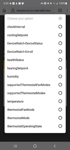

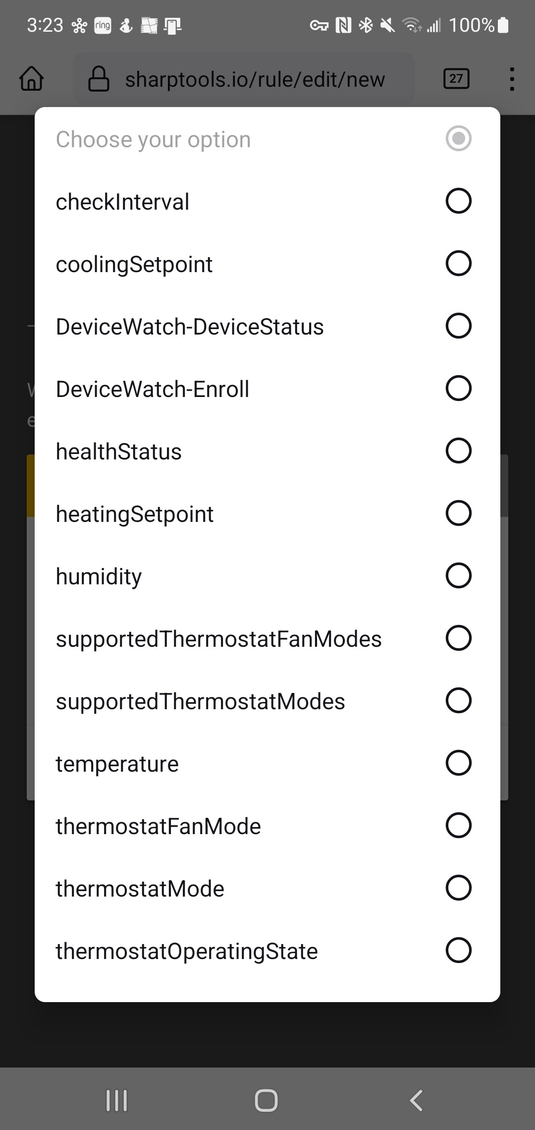

Here is what it’s available via the Ecobee–>ST integration. There is no Edge driver involved since its cloud->cloud.
Mine has those but includes 3 more:
Might vary by model.
That’s unfortunate. The motion sensor exists; the face changes when you walk by it. Would be great if it were available for use. My main floor thermostat is right outside a bathroom. I’m imagining the bathroom lights automatically triggering on as you walk toward it…
