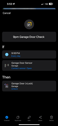

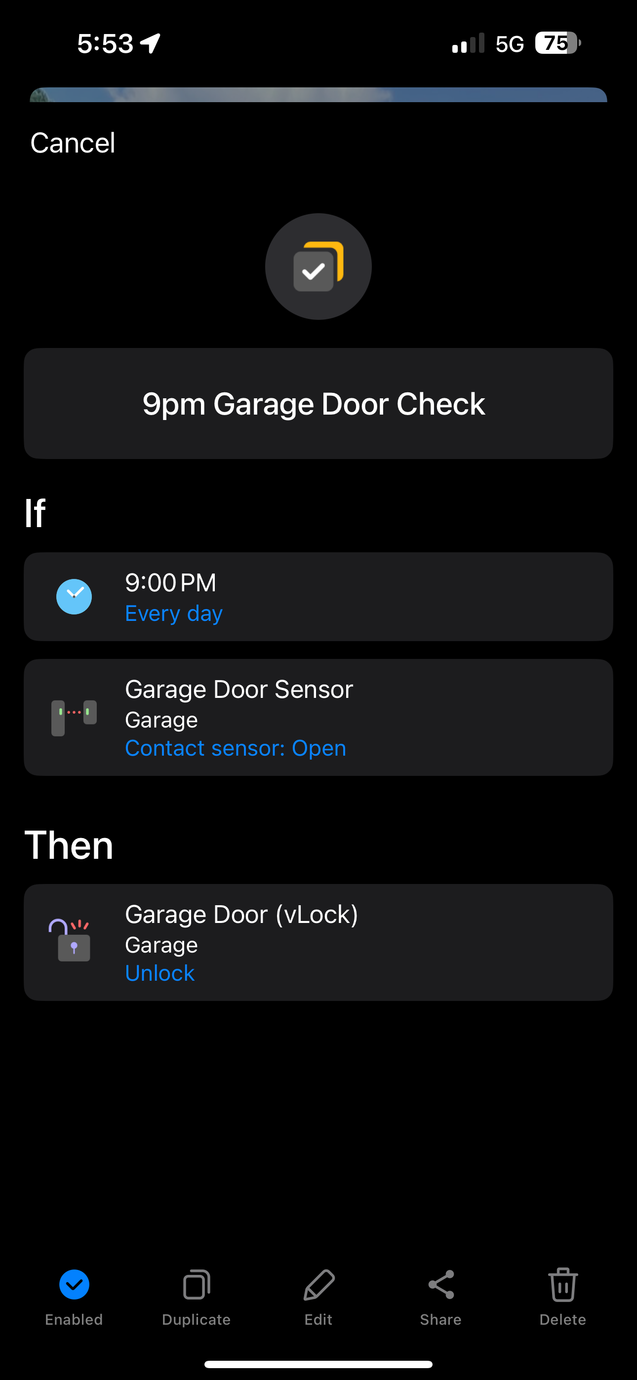

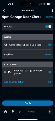

Thank you for all of the replies! I tried with the vLock and it WORKS! I swear I tried the vLock before and it didn’t show up in the Alexa app. Maybe I didn’t give it enough time to populate. I did find that the routine will run and work even when the vLock is already in the unlocked state. I think this has something to do with the “force state change” setting I read about in another thread. I tried to find that setting but was unsuccessful. Anyone know where it is located? Anyways, here is what my routines look like:
SmartThings:
Alexa:
