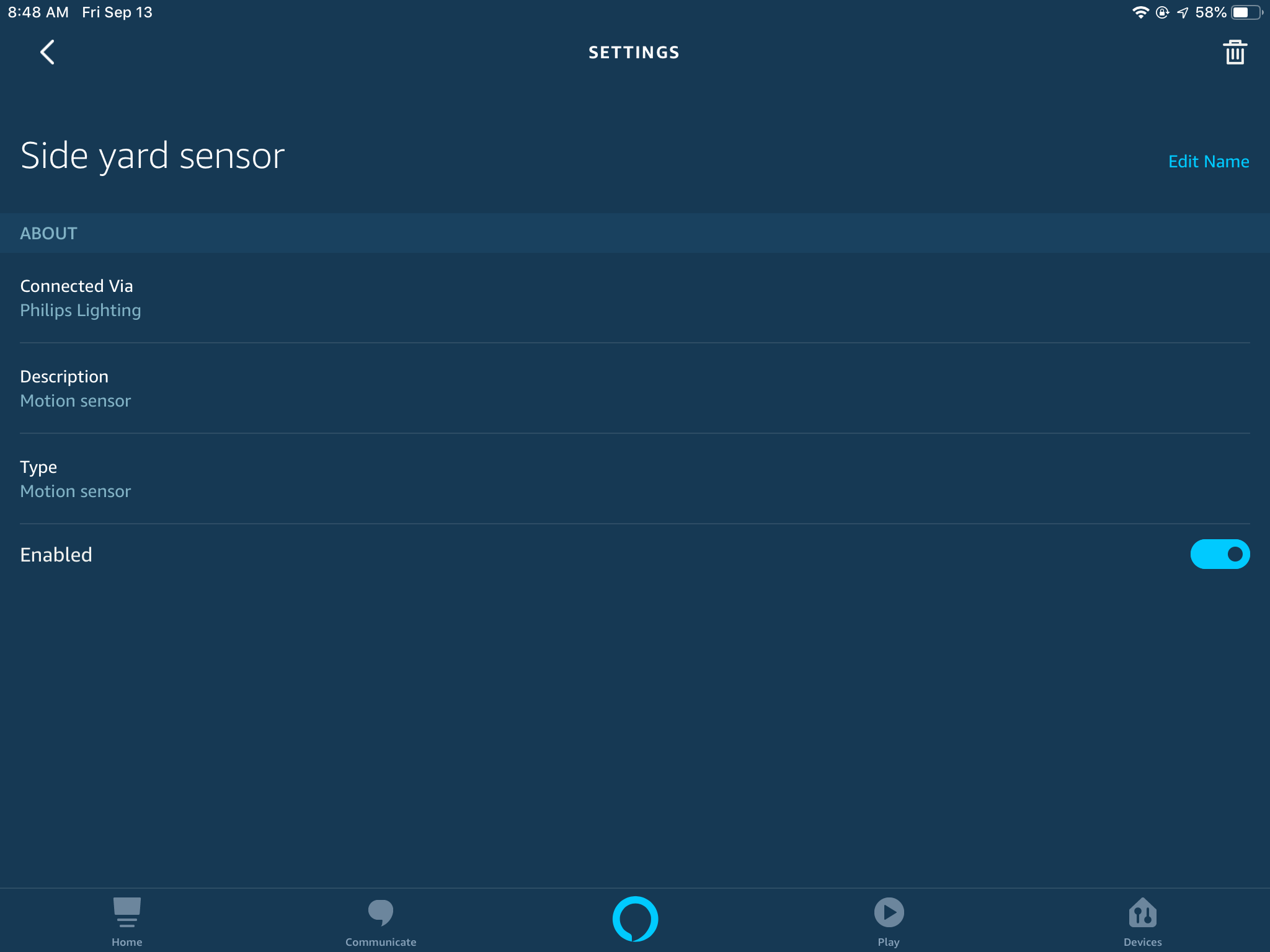

Also, can you put up a screenshot of what the sensor part of the device looks like in your Alexa app? Go to devices, select the sensor, then click on the little gears in the upper right. What we want to know is what the “type“ is on the detail screen in the Alexa app.

OK, the problem here is that you have selected the device which has a type of “switch.“ You should have another device in your list which is the contact sensor and has a type of contact sensor. Then you should be able to trigger your routine off of that.
If you are using the DTH from the FAQ, it will show up as two different devices in both smartthings and echo, one which is a switch and one which is a Contacts sensor. Make sure you have both enabled in the smart things app for use by echo.

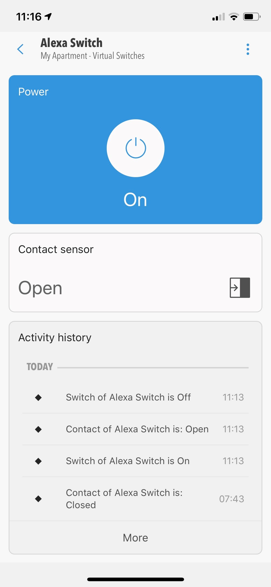

I think it may actually just be the time constraints I initially placed on it. I just added a dummy routine to have Alexa sing me a song from the app on my phone when I opened the virtual switch through ST and she played a song. So the virtual device can trigger a routine that was programmed in the Alexa app. I think having it set up to where the presence sensor automatically turned on the virtual device when I arrived was basically sending the signal to Alexa that she should run the routine then, but it wouldn’t run since the time requirements weren’t met. Here’s some screenshots of me opening the virtual device and the routine I made in the Alexa app with Alexa singing me a song.
