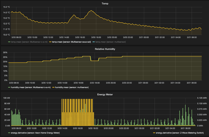

I added a little bit more details and a picture of the result in the github repo.
I also added my Grafana Dashboard to ease the setup if you are using this dashboard…
