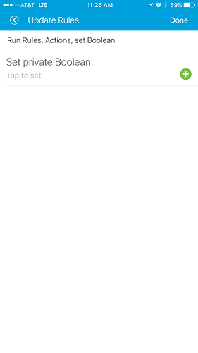

Hey Bruce @bravenel Did you remove the “Update Rules” option? I dont see it anymore in the list.
Nope, you discovered a bug!! Fixed now, just pushed 1.8.2c that fixes the bug.
No, it’s there under “Run Rules, Actions, set Boolean”.
I dont see it there - am I missing something?
Evidently!! That’s weird. I would suggest that you update Rule from Github, and see it that fixes it.
Did that and I still dont see it. I hope I wont have to delete everything and re-do… I’ve got over 30 rules.
What version shows in the bottom of Rule Machine main page?
Would you please go into the IDE, My Locations, List SmartApps, and click on Rule Machine. Post a screenshot of the Application State.
here it is.
Weird. It’s as if it doesn’t see any of your Rules.
Remove the Rule called “Update Rules”. Try a new rule and see if you get the same. Also, will send you a Private Message.
I had a similar problem last time. More awkward, i have 2 hubs, and in one I was able to see all the actions, and in the other I have limited actions.
I deleted RM, and then, I was able to see all potential actions…
The problem above was caused by an ill-advised change to the name of the SmartApp. Guys, “Rule Machine” and “Rule” are intimately linked BY THEIR NAMES. Do not change the name of one of them and expect it to work unless you know exactly what you’re doing. These names are referenced in the code, and are vital to the proper functioning of Rule Machine. This is because Rule Machine is a parent-child app, and for some good reasons, the children need to know the name of the parent, and vice versa.
