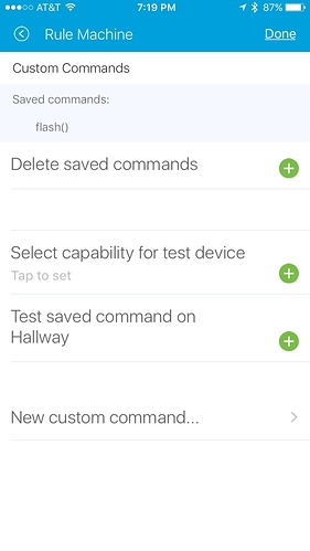

Why when I go to Expert Features it runs the flash routine you helped me with. So I am unable to see what is available. It wants to make a new custom command for Run Flash. I was looking for the capability.switch and others. As you realize I am guessing on what I have to do to make this work.
You need to undo your previous selections in Custom Commands to make new ones.
@bruce I wanted to follow up on this again. The new rules is now in place and I have replaced four old rules with the one new Capture/Restore w/Delay rule. Thanks!
Let me get this correct I have to remove the rules I created, if I do that won’t my Run Flash stop working?
No, you don’t have to remove any Rules. Just deselect in Custom Commands if you want to make a new Custom Command. Do not delete the Custom Commands you already made.
Do I deselect everything in custom commands or just the custom command flash? As of now I just deselected flash.
Deselect whatever you need to in order to select what you need.
I deselected everything but it looks like this now! And it wants to create new custom commands for Hallway which is the light that flashes.
So, can you select a new Capability?

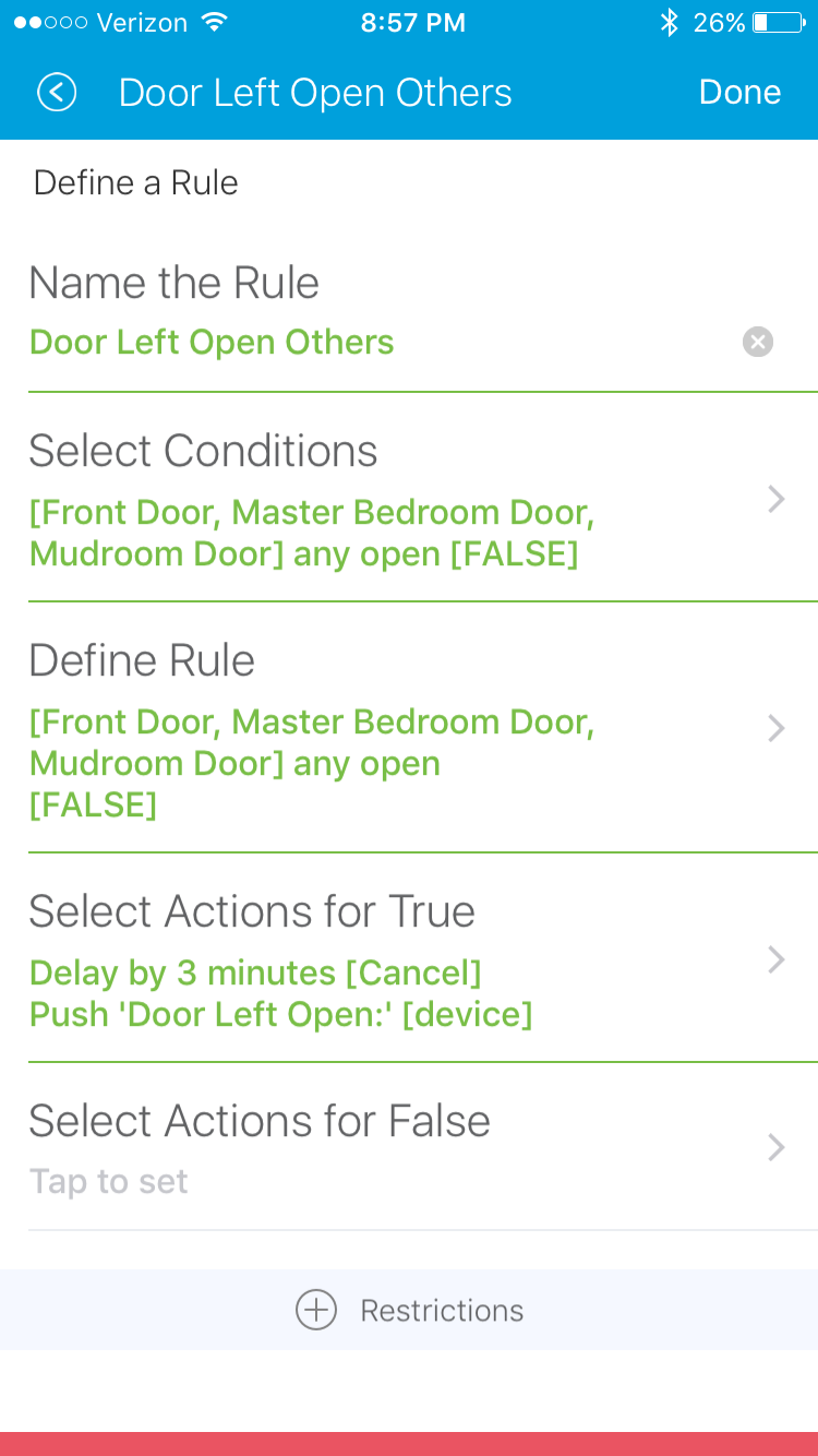

I’m trying to use rule machine to let me know if I’ve left any door open in my house. I choose ā€œcontactā€ as my capability, select all of my doors, true condition is to send me a push notification with a delay of 3 minutes that can be cancelled set to ā€œonā€. I’m getting a ton of false positives… we will just open the door and close it yet I get the notification that it was left open. I wondered if it would be more stable if I created 1 rule for every door, but that is still producing false positives. It has to be with the timing/scheduling, because the recent events of the doors themselves are accurate (meaning, they show opened and close within the same minute, yet I get a notice that it’s been left open for 3 minutes). Is there a more stable way to create this rule? I only have 5 doors.
to be fair, I also get false positives with the built-in SHM custom monitoring rule as well.

If you mean ā€œSelect capability for test deviceā€ yes if that is what you are referring to. If I hit New Custom command it shows for the Hallway. This is confusing as it seems to want to make another command for the Flash. I am probably looking at this wrong logically for what I want to do.

Can you post screen shots of your rule?
If you’re getting false positives with SHM also, you might have another issue. But let’s rule out the logic first.
I usually will have 3 more doors included in this, but again I tried to minimize the number of doors. I minimized the number of doors because sometimes my house gets busy… when we arrive as a family, it’s not uncommon for our garage door entry to my house to be opened and closed 3-4 times in quick succession, then we immediately let the dog out by opening and closing the backdoor twice in quick succession. Anyways, I was worried about the scheduling limitation.
IE: Garage door opens, timer starts for 3 minutes to check if it’s still open, it immediately closes but opens again within a second or two, timer gets stopped and started, while it’s being held open for the kids, the back door is opened, then closed, timers start and stop while garage door timer is still running… etc…etc… I thought maybe I was running in to a max so I created multiple rules, all identical to this one, but the busiest doors by themselves.
