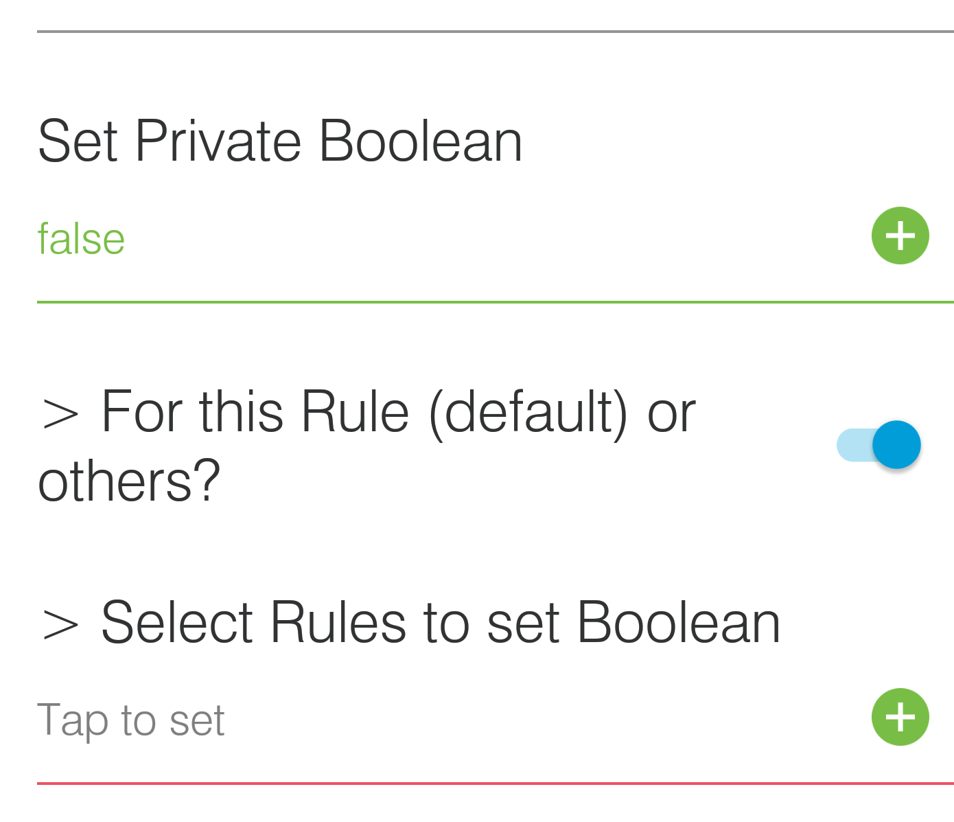

You can do this with a rule and a trigger:
Rule:
Conditions: back door open, private Boolean true
Rule: back door open AND private Boolean true
Actions for true: open garage door, private Boolean false
Actions for false: [none]
Restrictions: Day of Week: Monday, Time of Day 5:30 PM to 10:00 PM
Trigger:
Events: Certain Time: 1:11 AM
Actions: Rule Boolean [first Rule] true
The Trigger is just to reset the Private Boolean to true every Monday. This will run once on Monday, max, only when the door opens during the time.
@bravenel, this is bad a$$. I just built it and it works perfectly. Now I’m going to make it work on OR Tuesday morning. Thanks for the quick help and for the overall app. I look forward to better understanding the app so I may exploit it.
Bruce @bravenel , I must say, the rule boolean feature is PLAIN GENIUS! I was sitting on a rule for couple of days because I didn’t know how in the world I can pick the “Rule Boolean”, well I should’ve known that trying new things with Rule opens up a world of possibilities. Nice work, man!!!

Can someone please explain the difference between the private Boolean and any other virtual switch? They seem the same to me…?
You are correct. Private Boolean is very similar to a virtual switch. The two main differences are, (1) you don’t have to create it as a device, and (2) it can only be used within the confines of Rule Machine. For automations that need a virtual switch to hold state information, private Boolean fills the bill.
Ok, that’s kind of what I thought. Thanks!
I was able to get rid of most of my virtual switches with it.
