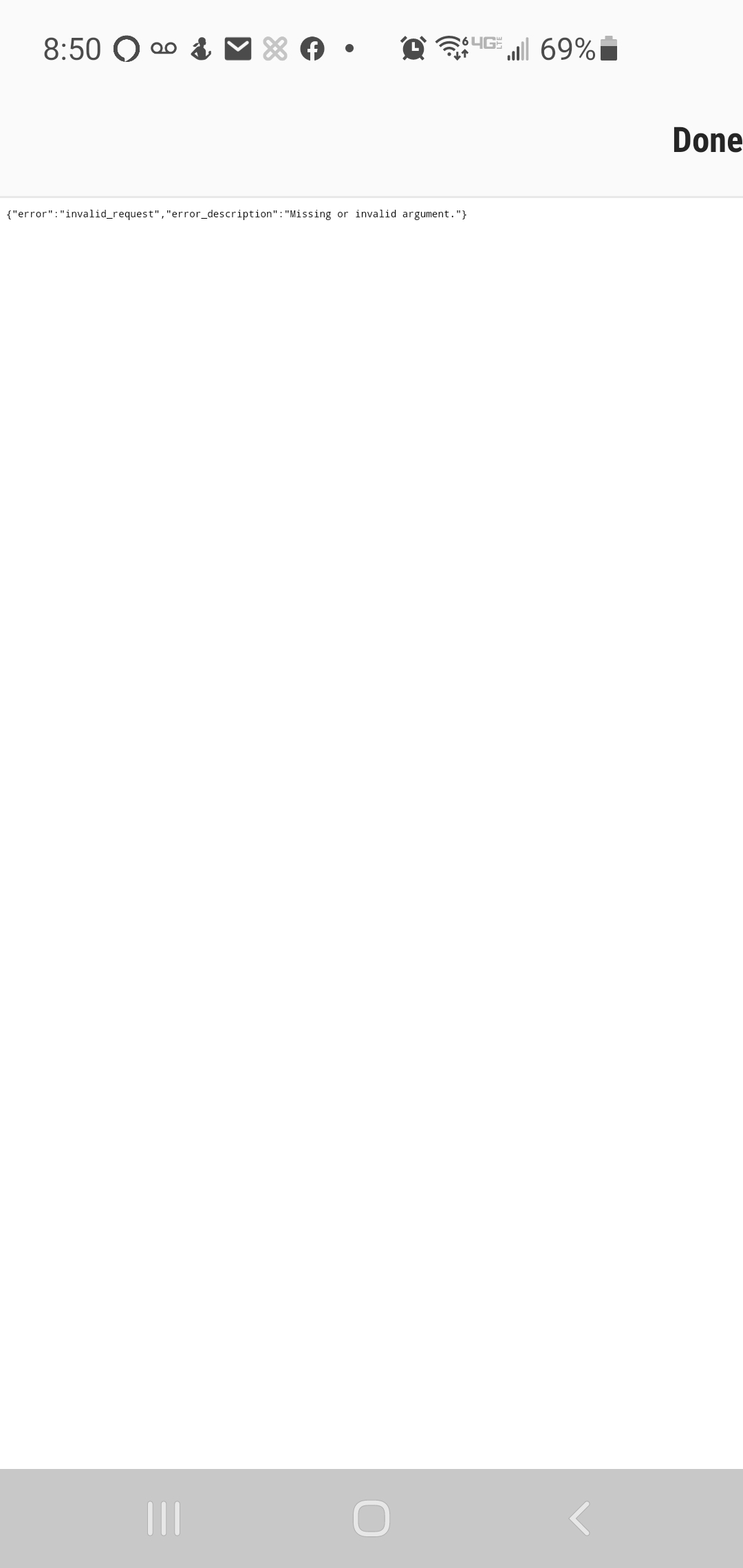

When I open the Logitech Harmony (Connect) Smartapp, this is what I get
When I click to enter credentials I get an error
But I can continue to allow Harmony device authorization.
try from the logitech harmony app, not from the ST app…
https://support.myharmony.com/en-us/harmony-experience-with-smartthings
Correct - and if it’s not working, delete the smartapp on the ST side and start over from the Harmony side. It’s got to get connected from that side properly before the ST side will work at all. THEN once that part works you can do the hurry up n wait thing to get the activities populated.
