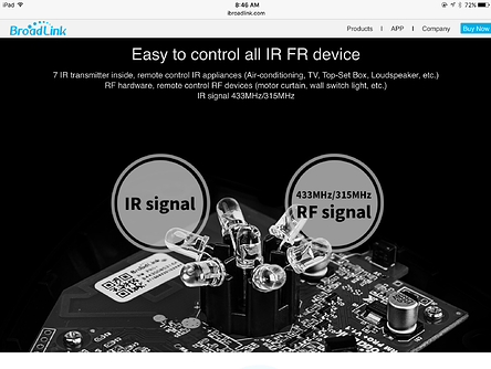

The RM Pro can do WiFi and two other RF frequencies:
The RM-Pro will control all RF devices/appliances working on the 433MHz & 315 Mhz frequencies .
No zigbee, no zwave, no Lutron.
433 MHz and 315 MHz are both popular for devices with short range simple button remotes, particularly audiovisual equipment and some HVAC equipment like fans, so that’s probably why Broadlink RM Pro selected those. But even though its marketing description says “universal RF,” it’s definitely not. It’s limited to devices on those two frequencies.
http://www.ibroadlink.com/rm/
