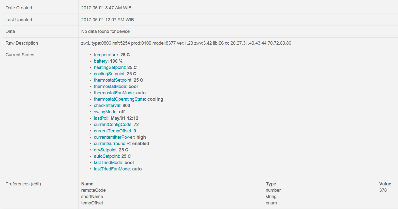

@ Eric,
Please find below my set up and how does it look on my apps:
What does it mean IR Config Code = 72? while I set the Remote Code 378?
Susena
That’s wrong. It is supposed to display the Remote code you configured.
Your code doesn’t look like my version so not sure where you got it. Try this version. The url you supplied isn’t my repo and doesn’t exists
If you are still having issues with my correct version of the code look in the IDE live log to see what is happening when you configure you code and when you issue the cool/heat commands.
Confirm you see the ZXT-120 flash when you issue the cool/heat setting.
