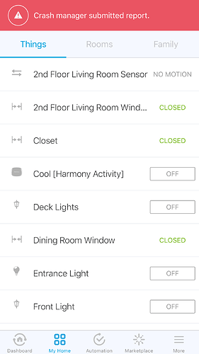

Dear Eric
Sadly after doing this, if I enter the remotec menu, smartthings app crashes…
Maybe something’s missing on the procedure?
Saludos / Regards
Nicolas Calderon G.
