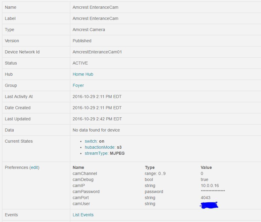

@Belgarion Thanks for this DTH. I tried installing the same and I think followed the steps, however I get the Error on the SmartThings mobile add “Camera cannot be found. We are trying to connect”.
Appreciate your advice…

Sorry about the late replay @skhandu… things have been crazy for me lately.
Based on the error information my guess would be that your Device Network ID. You can not have more than 1 device with the same Device Network ID in ST and, in the case of this DTH, the Device Network ID is calculate as a combination of the IP and Port used. Since the image is returned by the ST cloud to the Device Network ID IP and Port, your definition of “AmcrestEnteranceCam01” is causing the problem.
Try going into the configuration setting within the DTH again and change the Port to a different number, file it using “Done”, then go back in and set the port back to 4043 and file again with “Done”. When you view the device again in the IDE Devices List you should see that the Device Network ID has been changed to something else. Leave it alone and try your snapshot again.
I hope that helps.
You have the
@Belgarion - Thanks for your reply. I was able to get rid of the Device Network ID conflict - I had not removed my old foscam which had the same IP/port :frowning:. Removing it - the connectivity came back on.
