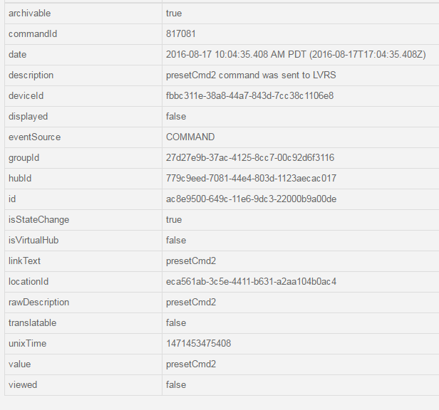

I followed your instructions and got the Amcrest IP2M-841 to work last night. I’m getting the video and audio through RTSP. However I can’t get the PTZ, and the preset to work.
I’m able to control it through the native Amcrest app.
For connection, it is done through DDNS.
Below is the log that I got. Hopefully you can help me to figure out what I did wrong.
Thank you.
Hi Mike,
I am using DDNS on one of my IP2M-841 cameras and the presets, PTZ and snapshots are all working fine. Let’s see if we can figure out what is going on with your setup.
You mentioned that you have the RTSP video stream working, so I assume you exposed port 554 on your router. However, all of the other functionality, including PTZ, work off of the HTTP port. Can you even get a snapshot? Did you confirm that the port you entered in the “config” settings of my DTH match the port that you exposed on your router?
The default port 80 is almost always only used with a local IP, so people typically associate a different port (like “8081” for CAM-1, “8082” for CAM-2, etc.) to their individual cameras and have their router forward the incoming data packets to the correct local IP on port 80.
Let’s start there and see where we get to. If you are still having issues, please turn on the debug mode and paste in the appropriate Live Logging trap for a PTZ command, commenting out any sensitive information of course.
Hi David,
I was able to fix my problem after reading your message.Thank you.
My mistake was setting the port in your DTH to 554 and left the camera HTTP port at 80.
Thanks again.
