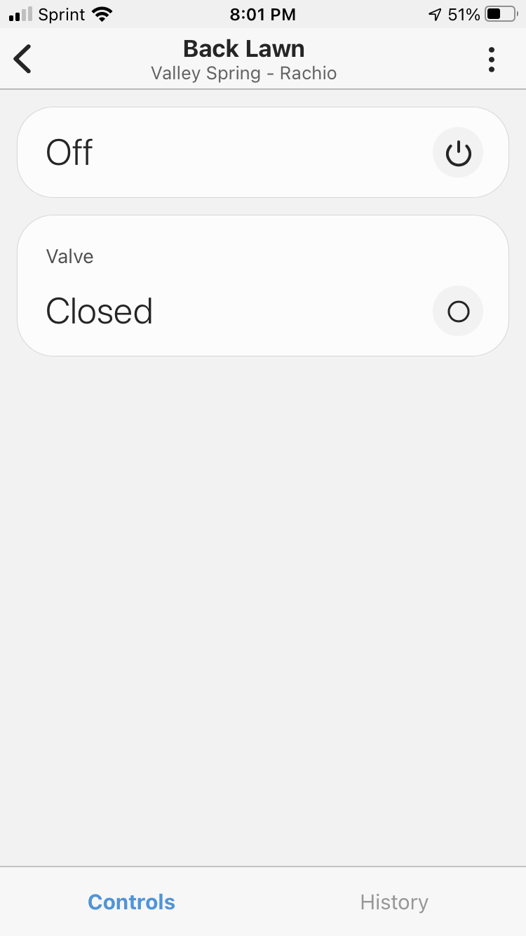

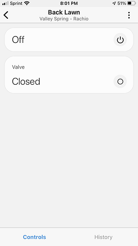

Rachio is a good system. It integrates w ST. Each valve shows up like a switch in the app. Not really sure how useful the integration is. I just use the Rachio app

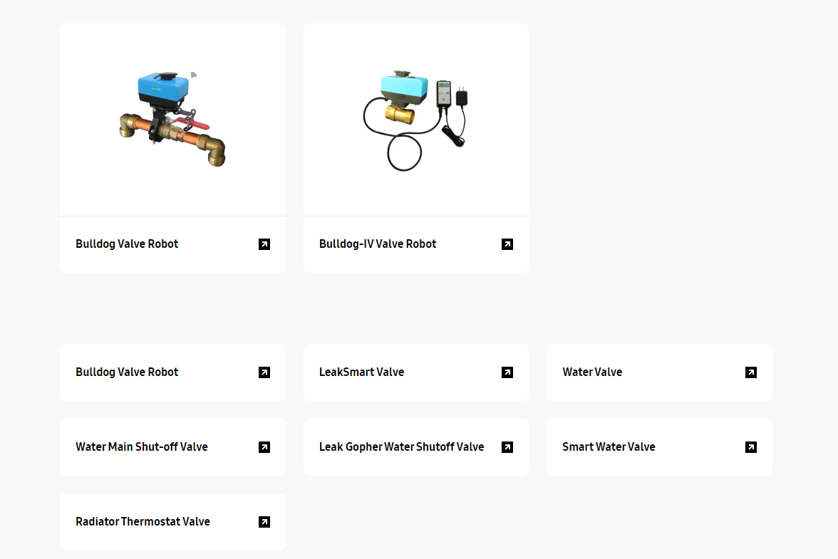

You can locate valve models to inquire about here at this link: or https://www.smartthings.com/search?term=valve
You can locate the full Intergration list at either of these links: https://www.samsung.com/us/smart-home/compatible-devices/
The models with direct integration will populate for you. The Model code matters so just ensure that you choose the associated one.
Once the information has populated, it will look like this:

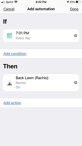

@Its2loud, Can you setup an automation to turn on and off individual valves?
You can in ST. See screen caps.
But the automations and schedules work better in Rachio and are changed per season automatically as well as weather changes.
