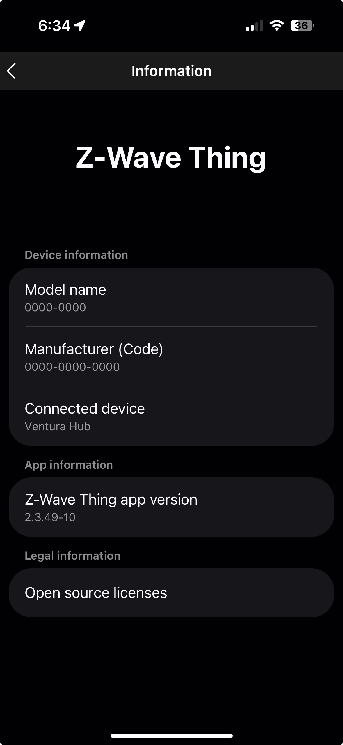

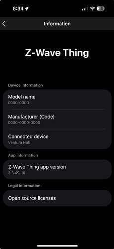

I can not exclude or include those devices reliably. For the most part no error, just does not find anything. I used one device that is used for holiday lighting and it would not exclude, so I used a different hub to exclude. When I managed to include it with my v2 hub it was not identified correctly. I tried the Z-Wave Device Config TEST it seemed to have an empty device ID. If I connect that same device to my other hub it pairs and detects the proper driver 'Z-Wave Switch and Child Mc. This is a Aeon Appliance Switch.

Also, for the Z-Wave thing device, I see that it’s reporting its fingerprint as 0000 in all the fields. Have you verified it has enough battery for the pairing process? Sometimes, when they don’t have enough battery, they behave strangely during this process.

The 0000 device, had a brand new battery, but I got the same result from a device that is AC powered.
