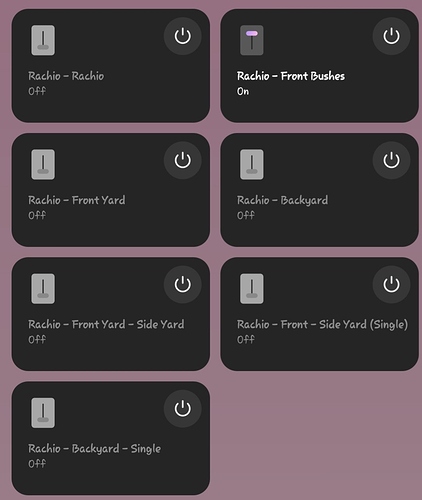

Yeah, the stock DTH. What happens if you turn one of the valves/zones on? Does it show as ‘on’ in the tile?
Not sure what you mean, but this is what it look like when the zone is active:
