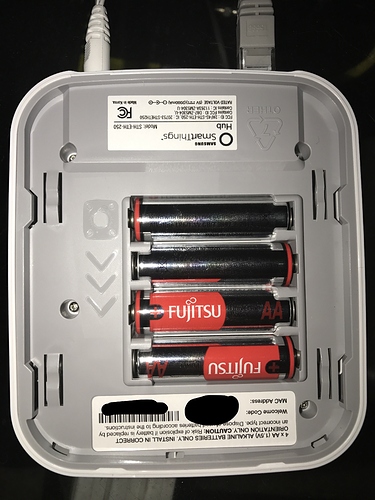

I just purchased my hub over the holidays. Mine were not Rayovac batteries. I didn’t read the manual but I am curious if lithium AA batteries can be used? Either way, may have been a bad batch of batteries from Rayovac?

I;ve had two hubs one with Panasonic batteries , no leaking and one with Rayovac , 3 out of 4 leaking…
My bet is on cheap batteries causing the problem.
