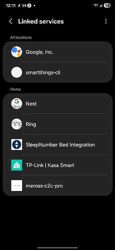

To fix this, please:
  1. Open the SmartThings app
  2. Go to Menu → Linked Services
  3. Look for SleepNumber, and if it’s disconnected, remove and re-link the account

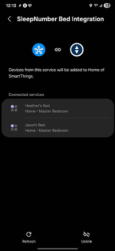

@Itati I had already gone through the re-authentication process. The service shows as linked and my two devices appear. I click Refresh and the Refresh icon disappears and everything else remains the same. Do I have to unlink and relink fully? I’m hoping that’s not necessary since the devices will disappear from my account and all associated automations will require repairing as a result.
