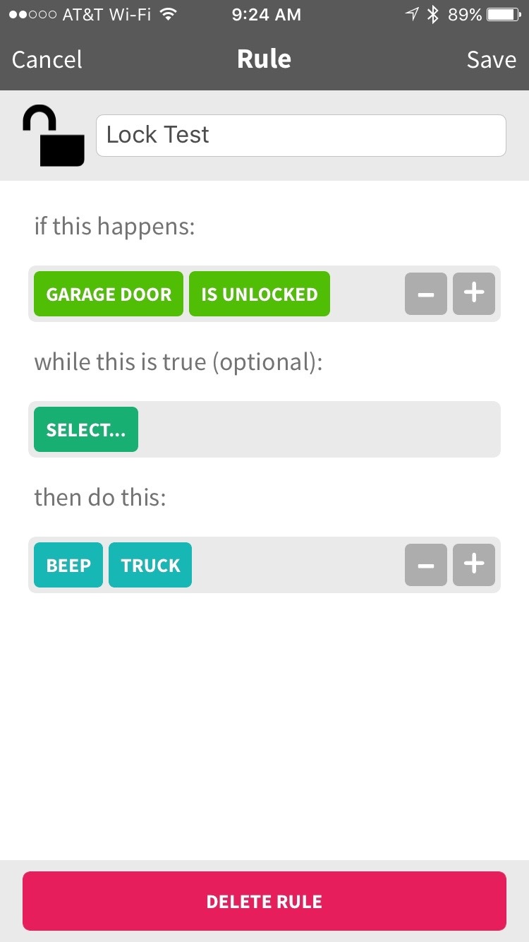

SmartRules can do this. It supports locks as a trigger and “beep” as an action:
